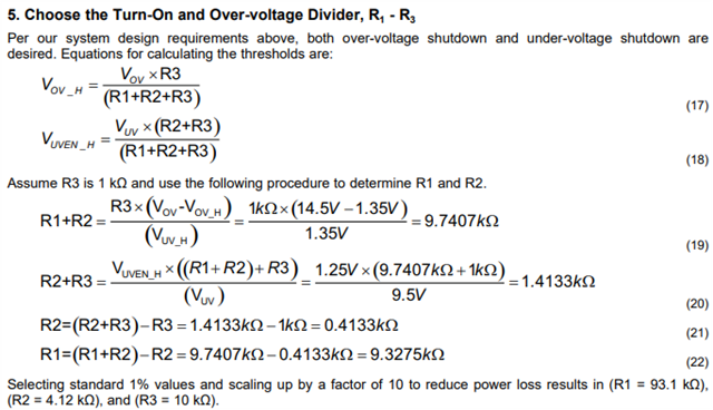

For  TPS2493 I would like to calculate the OV threshold and related resistor values using the TPS249x_8XDesign_Calulator_RevB Design tool.
This design tool spreadsheet has within section 5 the title UVLO, OVLO but within this section spreadsheet cells only contain results for UVLO and not for OV? Not sure why - when I watch the tutorial it shows the existence of more cells for this OV calculation. Am I using the wrong tool for TPS2493 OV function?
