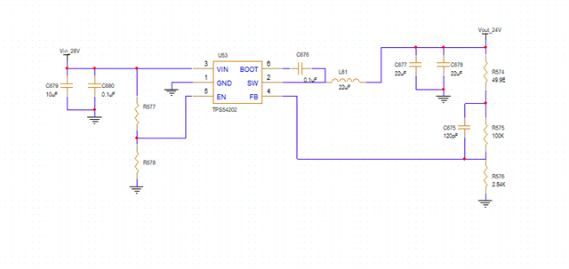

Hi Manogna,
May i know what is your requirement of 24V output?
Is 22V output is ok for you at 2A output?
Because we have a part https://www.ti.com/lit/ds/symlink/tps62932.pdf?ts=1756799317638&ref_url=https%253A%252F%252Fwww.ti.com%252Fproduct%252FTPS62932
The above part (TPS62932) will support 2A at 22V output.
Usha
Hello Usha
The output of the volatge regulator will go to PoE circuit in our schematic which requires an input of 24V,at 2A
If this TPS4202 doesnt support,i request you to please suggest an another alternative circuit where input is 28V and output is 24V
Hi Manogna,
With 28V input voltage 24V output voltage, 2A load current is not possible, TPS62932 can achieve 22V output voltage with 2A load current.
Usha.
