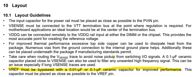

  • Paulo,
    Can you try adding a 0.1uF capacitor to the VREF output on the failing boards?
    Unless the datasheet specifically says you can leave a pin floating, I would recommend following the suggested passive components.
    Looking at the internal block diagram it doesn't immediately seem like the VREF should be necessary for device operation but if we look at the layout guideline we see VREF mentioned:
    Just based on this statement, it seems like the floating VREF might be an issue.
    However, if this doesn't solve the problem then I would recommend doing a customer quality return since I don't see anything else wrong with your schematic.

  • Hi James
    We tested another batch of 10 units, and in 2 units we observed the same issue (VC does not rise above ~1.2–1.3 V).
    As mitigation attempts: Added a 100 nF ceramic capacitor on VREF ,  no effect.
    Added a 100 nF capacitor on VSEN , no effect.
    Added an additional 22 µF in parallel with the decoupling capacitor on PVIN , no effect.
    These decoupling changes did not resolve the issue, We then replaced the LP2998 ICs on the 2 failing boards, and both became fully functional.
