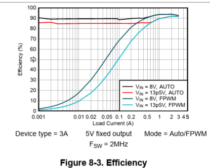

NOTE: Current circuit Changed to AUTO MODE
I have a requirement to meet the sleep current requirement.
Can you please provide the efficiency curve for lower load currents of around 100uA to 200uA as the below snippet is only till 1mA.
To meet the sleep current requirement as it has better efficiency at lower load currents I have changed the design to AUTO MODE by keeping the other circuit same
Hi Vinyas,
Talking with our team to see if we have this data. Will get back to you soon.
Dino

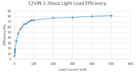

I would need 5V Fixed -LMR604305SRAKRQ1 as I will have to prove my design.
But until then please provide 3V3 Fixed data, will temporarily use that data in my calculations until you provide data for the 5V Fixed
Hi Vinyas,
Efficiency would be slightly higher, but very similar, within a few percent.
Dino
