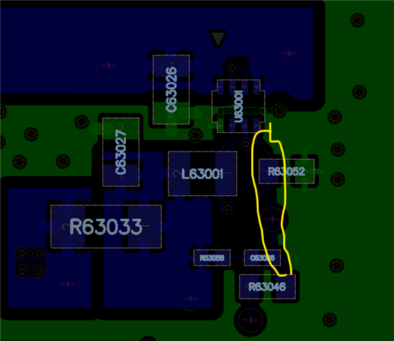

Hi experts please review the attached schematic and layout

    Layout review:
    • FB pin is very sensitive node. It is recommended to keep it short. In the layout, it is very long. I will recommend  to move the feedback divider closer.
    • Please also connect the bottom resistor of feedback network with IC GND to avoid any GND bouncing issue.
    • Also it is recommended to keep the snubber on the same layer as inductor.
