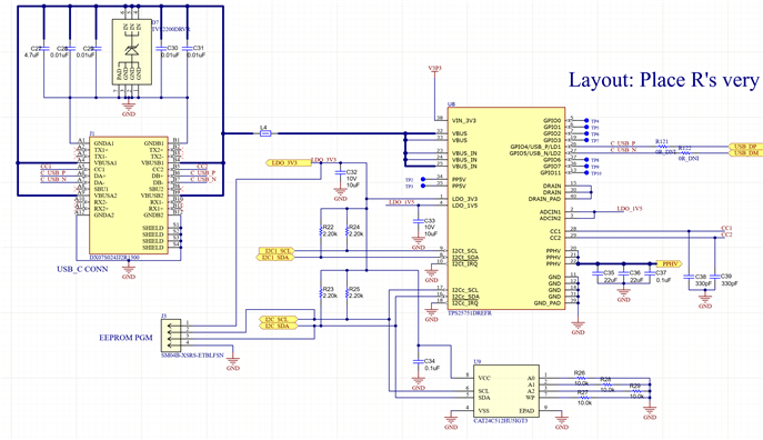

I now have my own design with TPS25751 for USB-C front-end, and a 2nd 20VDC input switched into the VBUS input of the charger by two external back-to back MOSFET circuits (excerpt below)
I am able to write the configuration file that I generate using the online config tool, into the EEPROM and able to negotiate 20V from USB-C, charger switches to the USB input  and charge up to 4A with USB-C port connected (PPHV above)

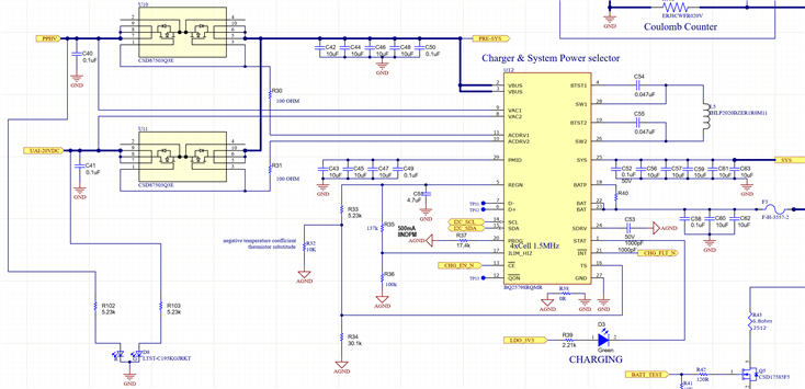

When the 2nd input is connected (UAI-20V above) only, meaning USB-C input is disconnected, charger switches to the 2nd input. ACDRV2 asserted, MOSFET is switched, I measure 20V at VBUS input pins. Good.
BUT charger never comes ON!  What am I missing? Is the charger not supposed to charge from the 2nd input? I do not se any mention of that on the data sheet.

  • Hi LZ,
    The TPS25751 firmware sets the charger's EN_CHG bit = 0 if no USB-C port is connected.  TI's power interface team is working on a fix for the firmware. I will move this post to them.
    Jeff

  • Hi LZ,
    Your EP can I2C write a 1 to REG0x0F[5] to the charger at 0x6B in order to enable charge.
    Jeff
  • Hi LZ,
    The TPS25751 integrated I2C control is optimized for a single-input use-case with BQ25798. Therefore, when the USB-C cable is disconnected, the PD sets the BQ to a safe state and disables charging.
    The TPS25751 supports I2C passthrough where it will write to the BQ through the PD I2Cc interface via a 4CC command 'I2Cw'

  • Hi Jeff,
    I have played with writing the EN_CHG bit and was able to charge from input 2, but it reverts back to =0 if I switch inputs. I want to be able to charge using either input, regardless of which one plugged in first.
    You mentioned initially that:
    "The TPS25751 firmware sets the charger's EN_CHG bit = 0 if no USB-C port is connected.  TI's power interface team is working on a fix for the firmware"
    I need this bit to stay EN_CHG=1 in either case, when input 1 is plugged in, or when input 2 is plugged in, so that I can charge from either port.

  • Hi LZ,
    Unfortunately, we currently do not have an optimized solution that is suitable for dual-inputs. The TPS25751 integrated I2C control is optimized for a single USB-C input to BQ.
    For applications with PD+BQ with dual-inputs, we highly recommend the MCU control the BQ for a more simple/efficient solution.
