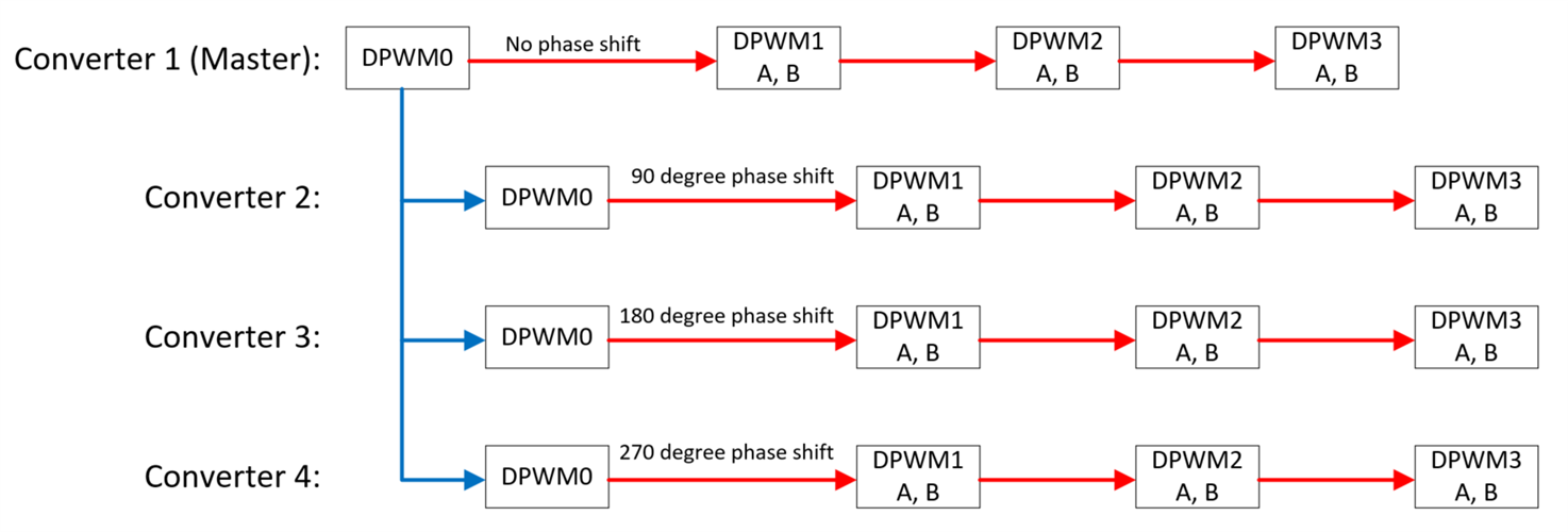

I need to control four different converters with 5pwm each (4 pwm and 1 synchronous rectifier). I need to have a phase shift between all the converters. That is, if Converter A is located at 0°, the next one has to have 90° and so on. A simple representation of this would be:
Converter A PWM 0 (A simple 50% PWM)
|‾‾‾‾‾‾‾‾‾‾‾‾‾|_______|‾‾‾‾‾‾‾‾‾‾‾‾‾|_______|‾‾‾‾‾‾‾‾‾‾‾‾‾|_______
Converter B PWM 0
‾‾‾‾‾‾|_______|‾‾‾‾‾‾‾‾‾‾‾‾‾|_______|‾‾‾‾‾‾‾‾‾‾‾‾‾|_______|‾‾‾‾‾‾‾
Converter C PWM 0
_______|‾‾‾‾‾‾‾‾‾‾‾‾‾|_______|‾‾‾‾‾‾‾‾‾‾‾‾‾|_______|‾‾‾‾‾‾‾‾‾‾‾‾‾|
Converter D PWM 0
___|‾‾‾‾‾‾‾‾‾‾‾‾‾|_______|‾‾‾‾‾‾‾‾‾‾‾‾‾|_______|‾‾‾‾‾‾‾‾‾‾‾‾‾|____
As it is said in the linked post, it should be possible through communication between different UCD7138. How is this communication done? Are there any application notes?

    Thank you for providing the required PWM waveform. All the UCD3138 controllers has a SYNC pin which can be used to provide an external signal to synchronize the DPWM outputs of the particular controller. That pin can also be used to generate a signal at the start of period of any particular DPWM of that controller. In this application, one UCD3138 can be used to generate a sync pulse which can be fed to other 3 UCD3138 controllers. You can refer to the following diagram:
    The Blue arrow represents the external connection between the different controllers and the Red arrows represent internal configuration of individual UCD3138 controllers. With this logic, DPWM1 outputs of all of the converters will be phase shifted by 90 degrees from the previous one.
    Please refer to the DPWM and LoopMux chapters in the Technical Reference Manual of UCD3138 for more details: https://www.ti.com/lit/pdf/sniu028
