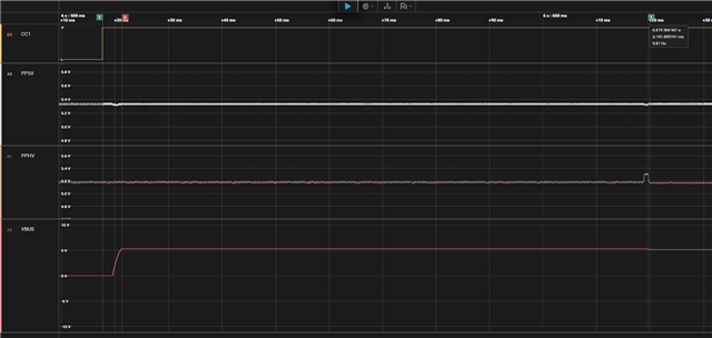

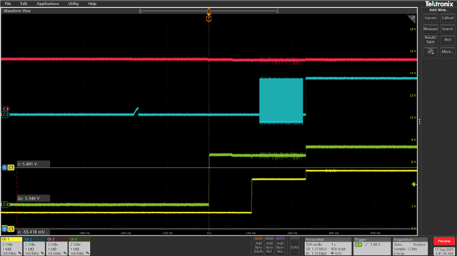

Hi Everyone,

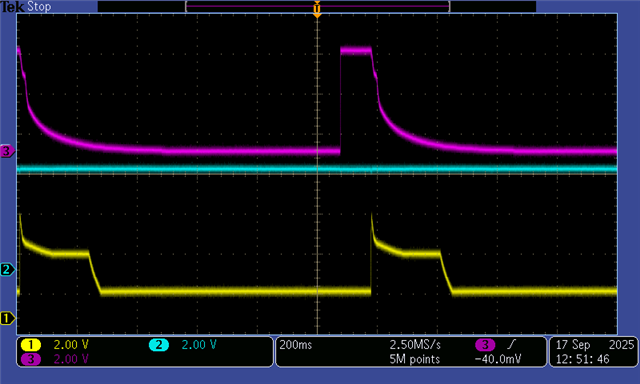

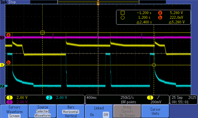

I already mention about the problem in here.
 RE: TPS25751: TPS25751EVM + Bq25756EVM Power Path for PDO 1 PP1 and PP3 Source Issue

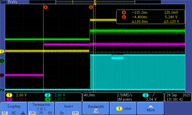

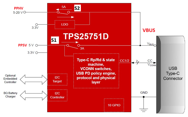

I used good boost converter for the supply DRV_SUP and PP5V from 1 Cell application. TPS25751 goes into hiccup mode since the switching sequence and PP5V supply to the VBUS was not managed well in my opinion.
Please check the attachment report which is in detail information about the setup, settings and oscilloscope SS.
I need to find how I will fix this problem. The aim is that use 5V generated from boost converter from 1 cell with limited current 500mA for PP5V connection. I want to supply for 5V/3A source VBUS from PP3.

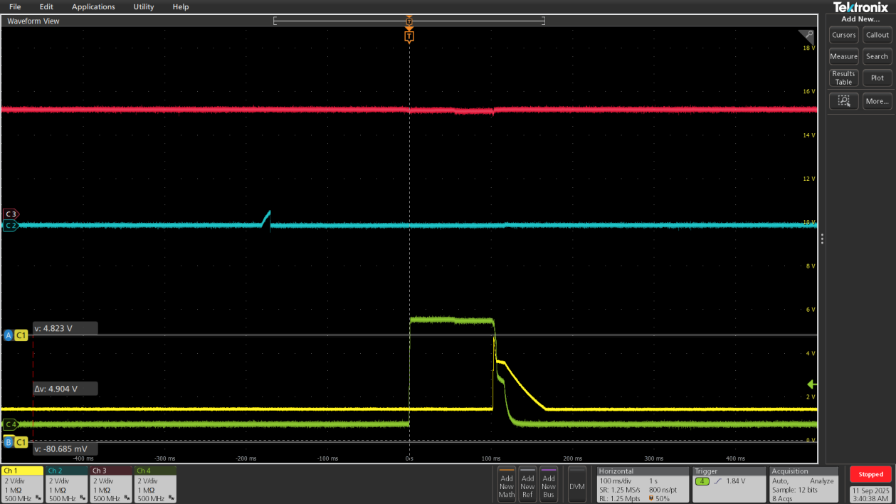

    Thank you for the detailed report.  I have also reached out to the BQ team regarding why the 4.7V on DV_SUP works but 5.0V does not.
    Chris

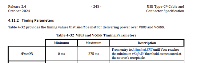

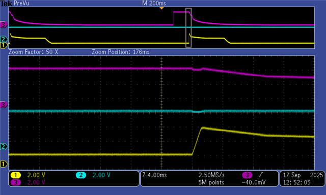

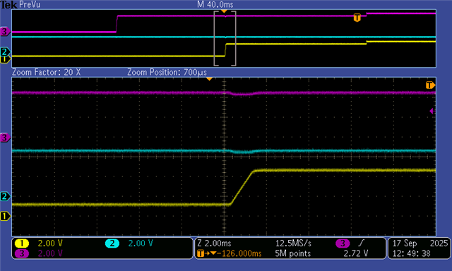

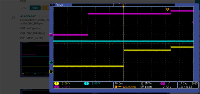

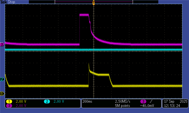

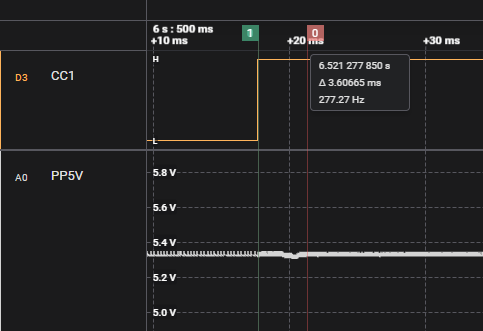

        Do you have the ability to increase the capacitance on the DRV_SUP and also retest with the LDO replaced with a stronger 5V to see if the issue is with the DRV_SUP.
        Also, in the 5V case (vs the 4.7V) do you see anything from the PD controller writing to the BQ?  I am curious in the transition from PP5V to PPHV if the PD thinks there is a reverse current event and the 4.7V does not trigger.
    Chris

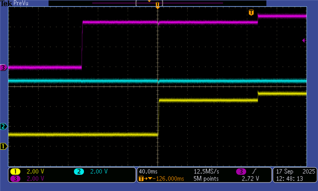

  • Hi Chris,
    I’m using programable psu 4.7V or 5V supply. I also dont see any dropout in the oscilloscope. I draws 30ma to 300ma. No dropout also in the ldo 3.3v.
    I will sniff Monday morning between bq and pd update in here. Actually the main problem in my opinion is that pd enable vbus before not the enable switching on bq. It cause immediate drops on the vbus then bq sense the vac drops (most probably short circuit or overload) pd goes into the hiccup mode.
    Why 4.7v not effected this situation, it might be usb pd protocol don’t allow the enable vbus since the uvp. When the transection is finished vbus supply coming from bq 5v pd on the vbus enabled.
    is it possible such a this scenario? Is it possible to setup and test it with 1cell with nominal 3.2v? Do you have facilities to simulate in your lab?

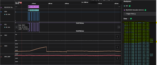

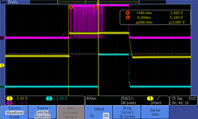

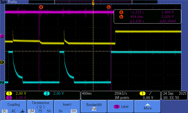

  • Hİ Chris,
    Here is the communication sniffer data for PP5V supply with 4.7V and 5.0V.
    During supply with the 4.7V the source is starting to charge successfully and here is the data;
    write to 0x6B ack data: 0x19 0x01
    write to 0x6B ack data: 0x17 0xC8
    write to 0x6B ack data: 0x19 0x01 write to 0x6B ack data: 0x19 0x01
    write to 0x6B ack data: 0x0C 0x10 0x04
    write to 0x6B ack data: 0x0A 0x04 0x01

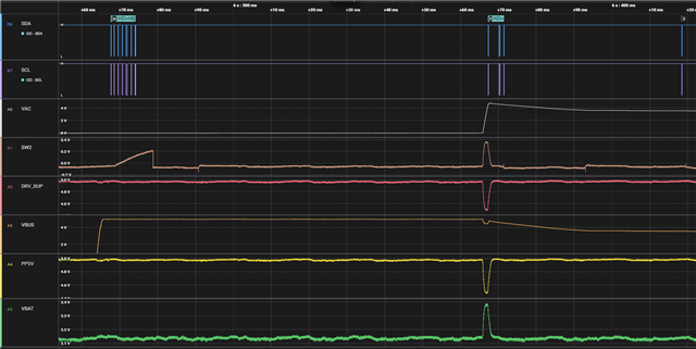

    When I set supply with the 5V for PP5 the source is goes into the hiccup mode and here is the data;
    write to 0x6B ack data: 0x19 0x40
    write to 0x6B ack data: 0x17 0xCC
    write to 0x6B ack data: 0x0C 0x04 0x04
    write to 0x6B ack data: 0x0A 0x4C 0x00
    Can you provide some images?  with and without additional capacitance on DRV_SUP.  The testing on my side is a little more involved than i had planned and need to have some additional justification.
    Thanks for your patience.
    Chris
  • I added 470uF at DRV_SUP pin and here is the pictures with 4.5V supply (working) and 5V supply (hiccup) pictures. You can see there is no dropout at the DRV_SUP pin.
    CH1: VAC (yellow)
    CH2: DRV_SUP (Blue)
    CH3: VBUS (Purple)
    DRV_SUPP=4.5V No Cap
    DRV_SUPP=4.5V No Cap (Zoom)
    DRV_SUPP= 5V No CapDRV_SUPP= 5V No Cap
    DRV_SUPP= 5V, Cap=470uFDRV_SUPP= 4.5V, Cap=470uF

    Can you test your system without the TPS25751?  Specifically, send the I2C commands to the BQ using an I2C tool and measure how long it takes for the 5V to turn on?
    Chris
  • Hi Chris,
    I disconnected the ribon cable and used the BQStudio with EV2400. I clicked "EN_REV" to ON of the VBUS. Here is the graph.
    Purple is the SMBUS SDA pins coming from the EV2400.
    Yellow is the VAC.
    Blue is the VBUS.
    The time interval command to the VBUS 1.6sec and after VBUS high 100msec later VAC is activated. As you see from the graphs when the command is sent at the time curssor "a", the fist trying is failed and the second one is successfully set.
    I will need to confer with the BQ team.  The PD spec requires to provide VBUS within 275ms, so waiting for 1.7 seconds is not feasible.
    Chris
  • Hi Chris,
    I was saying at the begining of this thread. This is the sequence issue in my opinion. PP5V is already supplied on the TPS25751 even the less current limited. When we select Power Path for PDO 1 PP3 Source, the sequence is supplied from PP5V with short duration. The only things to do not activated the VBUS until the conversation is finished from BQ25756 side. When the PD see the voltage level 5V on the VAC, then activated the VBUS, then the source can cause immedialtely drop on the VBUS since the there is no switching.
    I think the TPS25751 must be check from BQ via communication switching started or not, not the voltage level of the VAC. This phenomena can explain why this system is also working 4.5V supply. When we supply 4.5V to the PP5V and DRV_SUP, TPS25751 not enabled the VBUS since the VBUS voltage under 4.75V, then the BQ25756 is started to switching 5V is seen  at the VBUS and TPS25751 is activated VBUS successfully.
    But the VBUS is enabled when the supply is 4.5V.  You can see it is 4.5V here.
    Chris
  • There is a misunderstanding about the phenomenon, let me clarify it. I believe that PP3 and PP1 have a sequence order to supply PDO1.
    Under normal conditions, PP1 supplies the bus. We can observe that 4.5V and 5V VBUS are activated by PP5V. S1 remains closed and continues supplying until the required VBUS is enabled.
    While supplying 4.5V, if no voltage detection or protection is triggered on the VBUS, S1 stays closed and keeps supplying VBUS. This voltage level is less than 4.75V, which provides some time for the switching delay coming from PPHV. At that moment, the PPHV voltage level is also below 4.75V. Then, we can see a step-up at the VBUS level, and it starts successfully.
    When supplying 5V, at the initialization stage PP5V starts supplying VBUS, as already observed. Once initialization begins, PPHV immediately reaches 5V, and the TPS25751 causes S1 to open and S2 to close. As a result, the load consumption immediately decreases the voltage on the VBUS.
    If somehow S1 not closed imediately or wait a moment a little bit the problem will be solved. I research also why the S1 is closed, we may trigger RCP but I'm not sure about this.
    "If VVBUS - VPP5V > VPP_5V_RCP, then the PP_5V path is automatically disabled within tPP_5V_rcp. If the RCP condition clears, then the PP_5V path is automatically enabled within tON."
    PP5V = 4.5V
    PP5V = 5V

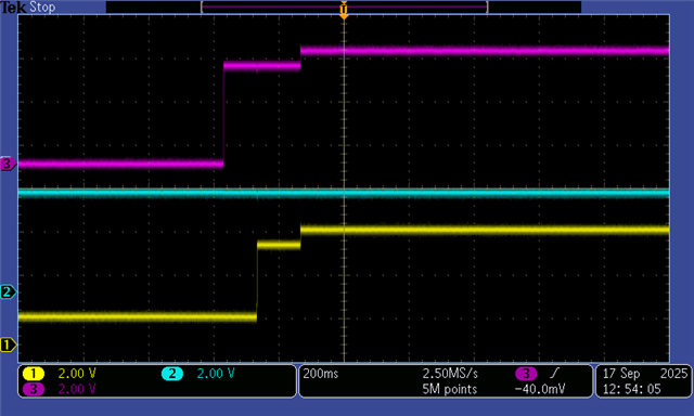

  • Hi Chris and Ethan,
    I tried 7.2V VBAT and it was worked. When atteachment on the load SW1 is starting imediately switching before VBUS enabled. If we supply 3.3V VBAT, there is no switching at the SW1 :( Why it's not switching, why is not starting whats the real reason?
    Yellow VAC
    Blue VBUS
    Purple SW1
    At VBAT=7.2V
    At VBAT = 3.3V

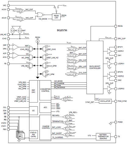

    The BQ25756 gets initial power from SRN (which is tied to the battery voltage) when starting reverse mode.
    REGN is used to power the internals of the BQ25756.
    DRV_SUP provides power to the gate drivers.
    The IC doesn't have enough voltage to start switching with only a 3.3V battery source.
    I'll let Chris respond to the questions for the charging characteristics.
    Ethan Galloway
  • Hi Ethan,
    I see in the block diagram. The last question for this issue. What happens if I supply REGN with external 5V? Is the LDO have reverse protection diode for the supply side(Vac and Vsrn)?
    There are no hooks or parameters made available to change or control the power path timing.  These are set in the device to comply with the USBC-PD specification.
    Please refer to the following for your reference:
    PDO1 is set to PP3.
    Time from connection to presentation of VBUS(PP5V) ~3.6ms
    Time from connection to switch from PP5V(PP1) to PPHV(PP3) ~100ms
    Regads,
    Chris
  • Hello Ali,
    The IC should have reverse protection to the supply side (VAC and VSRN) from REGN.
    I think you can make the circuit work by only applying 5V to REGN when starting reverse mode and then disabling the external 5V afterwards. Let me know if this will work for your system.
    Ethan Galloway

    I added load switch circuit as can be seen from the below picture
    CH1-Yellow: VAC
    CH2- Blue: SW1
    CH3-Pink: VBUS
    CH4-Green: REGN
    With this circuitry, PP3 Source for PDO1 was worked successfully. The only consideration about applying DRV_SUP during VAC is less than 5V can cause any damage or is this have any disadvantages?
    whats your opinion?
