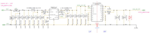

Here is Hella R&D, We used UCC12041-Q1 for isolated DCDC application
Schematic diagram as below:

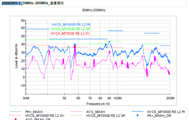

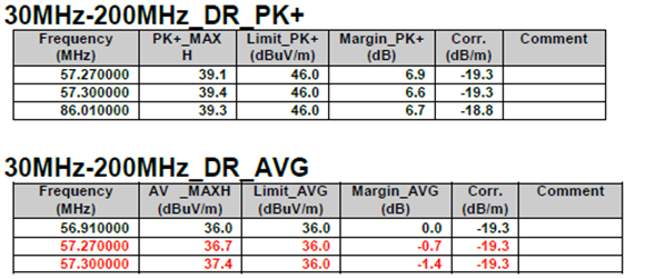

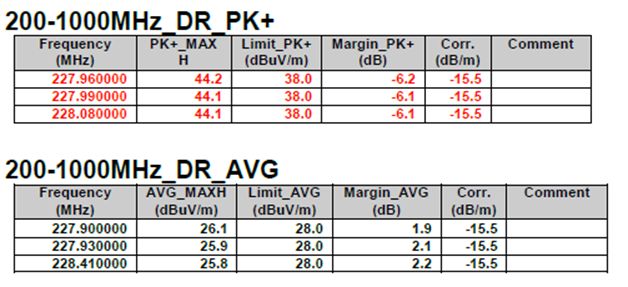

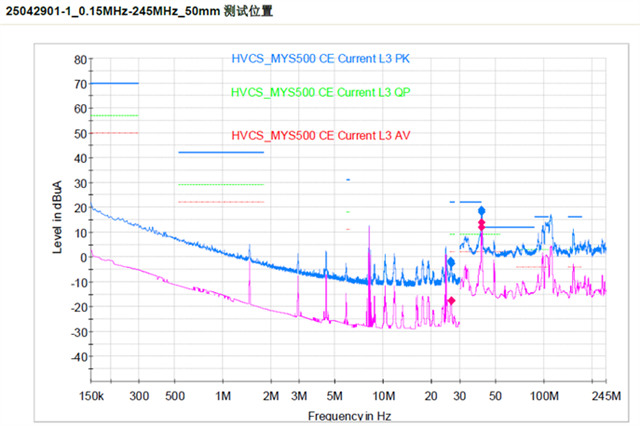

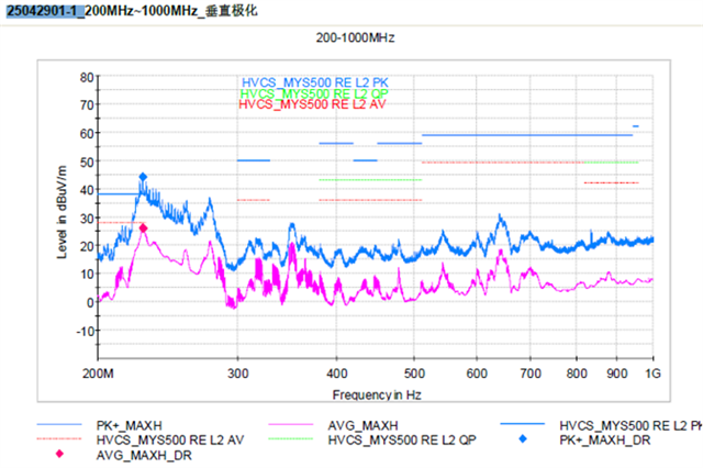

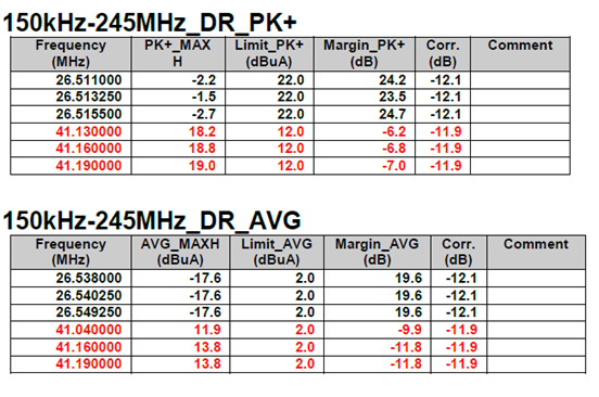

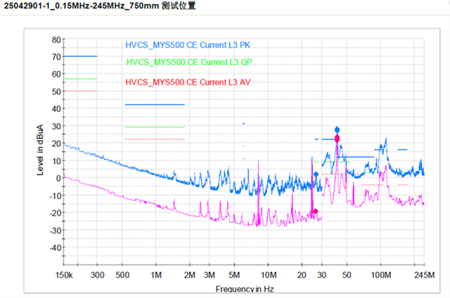

Our product failed in RE/CE test , the result as below
Can you support to fix this issue,?
pls. share your comments and countermeasures
Two more question:
1,does common choke inductor mandatory?
2,Why Y capacitor recommended 110pF? theoretically 110pF will pass more high frequency to input power line, which will cause CE test fail more easily
Test result as below
CE fail, 41MHz
RE fail, 57MHz, 227MHz
