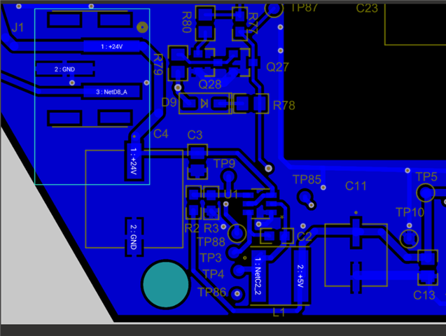

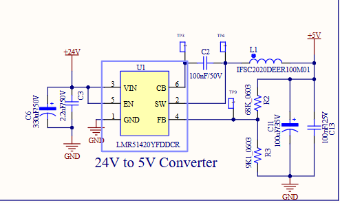

I am using this IC as a buck converter (24V to 5V). The circuit is already in mass production with a volume of over 15k units per month.
However, we are facing an issue that is rapidly increasing: the IC is either shorting to GND or burning out immediately when power is applied. In some cases, the IC even fails during the impedance check on the FCT tester, before any power is applied.
Could you please suggest the possible reasons for this failure and recommend any potential remedies?
Attaching my schematic for your reference.
  • Hello
    Can you supply images of your PCB layout.
    Also, please give details on your impedance testing.
  • Here is the PCB layout.
