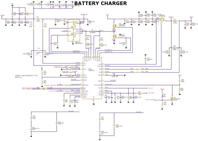

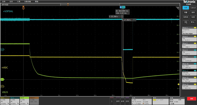

When testing BQ25710, we found that when the equipment was turned off, the VSYS will loses power after about 20 seconds of unplugging the adapter and recovers after 3 seconds.
The schematic is as below:
The waveforms we captured are as follows (blue for VDC, yellow for VSYS, green for VBUS):

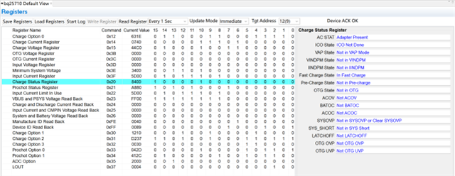

The register settings are as follows:
