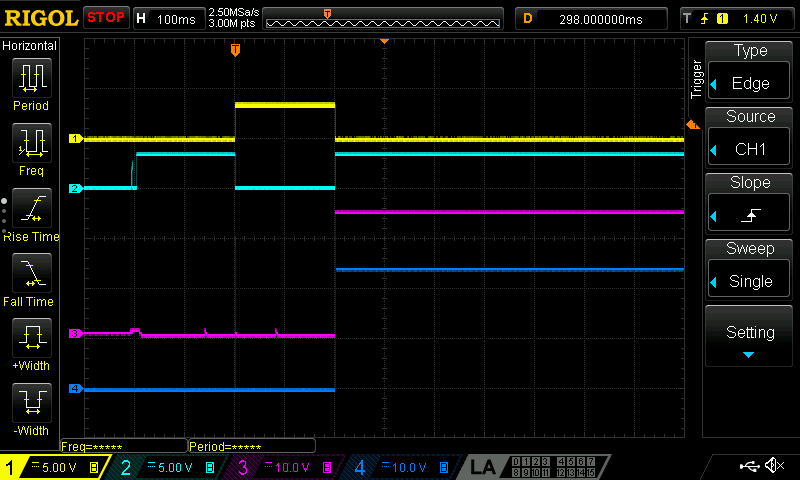

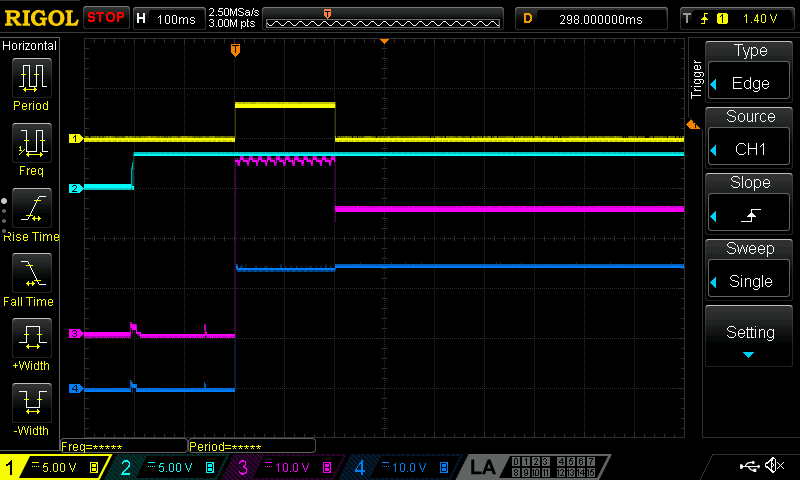

Input 1: INP_G, Input 2: INP, Input 3: G, Input 4: GATE
No load starting works fine. This same sequence of INP_G high for 200ms then INP high is repeated for the scope captures below.

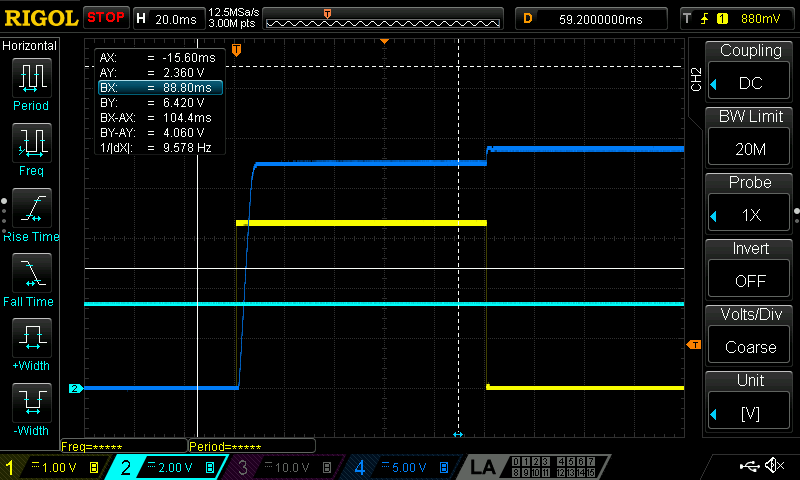

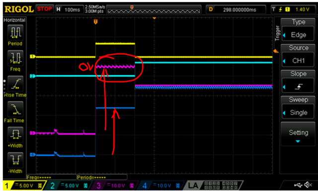

Input 1: INP_G, Input 2: FLT, Input 3: G, Input 4: Output Voltage

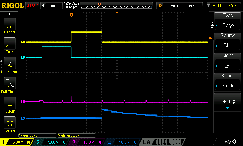

100 Ohm resistive load. Driving INP_G high causes FLT to assert (low). Soft start mosfet does not switch on.
10uF capacitive load. Driving INP_G high causes FLT to assert (low). Soft start mosfet does not switch on. Main mosfet switches on but turns off very quickly causing output capacitor voltage to increase rapidly but then discharge again.

    Looking at your first scope shot I'm concerned that both of your gates appear to be driven high when INP_G is high. Per your labels CH4 should remain low during this time if INP (Ch2) is LOW.
    Sarah

    I am confused by your comment as the first scope shot shows G going high (Vout+~10V) when INP_G is high and GATE going high (Vout+~10V) when INP is high. You can see the ripple from the charge pump. Vout+~10V means the VGS of the mosfets should be sufficient to turn them on only when their respective controlling inputs are high. This is what I would expect. When the controlling inputs are low, the gates are at Vout but not above it.

    My main concern is the FLT output shown in screen cap 2-4 asserting (low) for some reason.

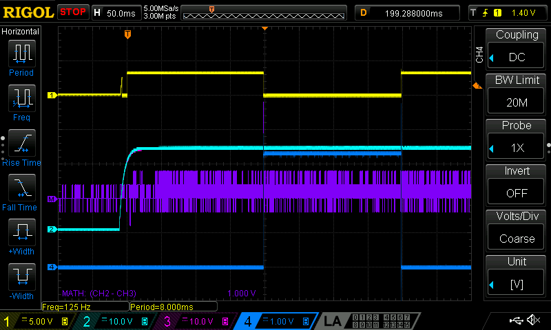

    Input 1: FLT, Input 2: DRN, Input 3: CS2-, Input 4: INP_G MATH: DRN-CS2-
    Here we can see around the time INP_G goes low and FLT asserts low, there is a spike on the MATH trace (DRN-CS2-) that goes up to several volts, certainly above the 2V threshold.

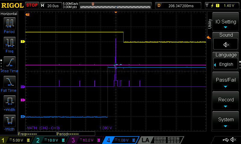

    Input 1: FLT, Input 2: DRN, Input 3: CS2-, Input 4: INP_G MATH: DRN-CS2- (1V per division)
    We can see that INP_G (4) goes high first, then we get the spike on the MATH trace (DRN-CS2-) that goes up to ~3 volts, then FLT (1) asserts (low).
    I have the recommended filtering on DRN (see section 9-3 of the data sheet) but I have removed it in the capture above to make the filtering on DRN and CS2- more similar to try and reduce the spike. I assume I would need to add similar filtering on CS2- but that will be very difficult on my PCB as I have not allowed footprints for it.
    Am I correct in this line of thinking?

    You labeled the Ch2 as INP. In this waveform both G and GATE are high, while INP is low. Gate should not be high here.
    For the above it seems like you might now be pre charging correctly. You have an RBypass = 12 ohms which seems high for 2A --> This would be closer to 1 ohm.
    We do not typically recommend filtering on CS2- and this does not look like noise as much as improper pre charging. Your voltage drop is too high across the bypass resistor indicating you have more current than expected.
