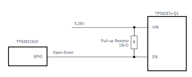

Hi support team,
As shown in Figure 2-1 of SLVUD09, I am connecting the GPIO of the TPS6521910 to the EN of the TPS62872-Q1.
www.ti.com/.../slvud09.pdf
TPS62872-Q1 support told me that the TPS62872-Q1 requires a pull-up resistor of 15kΩ or more.
e2e.ti.com/.../6054216

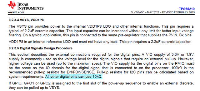

The TPS65219x checklist states that the typical value is 1kΩ to 10kΩ.
www.ti.com/.../slvafe2
The datasheet seems to recommend 10kΩ.
Is it okay to pull up with 15kΩ as shown in the diagram below?
Dice-K
  • Hi Dice-K,
    Yes, the 15kOhm pullup resistor will be fine here.
    10kOhm is just suggested as a typical value for balance of power consumption and noise,
    The discrepancy between 10kOhms and 15 kOhms will be minimal.
    Sarah
