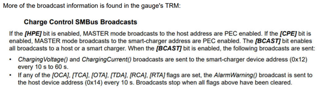

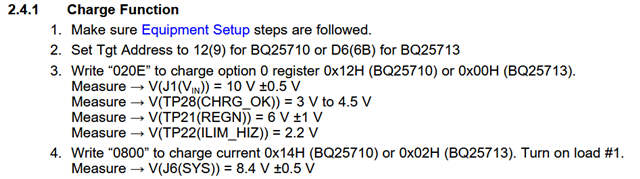

I have assembled the system detailed in the Autonomous Smart Batter Guide Application Note. I've completed the gauge setup including calibration, ChemID configuration, and a learning cycle. I have now put my system together with the BQ25710EVM charger as detailed in the application note. I am using a 6 ohm resistive load on the system load header on the BQ25710EVM for discharge.
I am however unable to control when charge and discharge happen. Is there something in the setup I have missed or some configuration that I need to do that isn't included in any of the referenced documentation?
