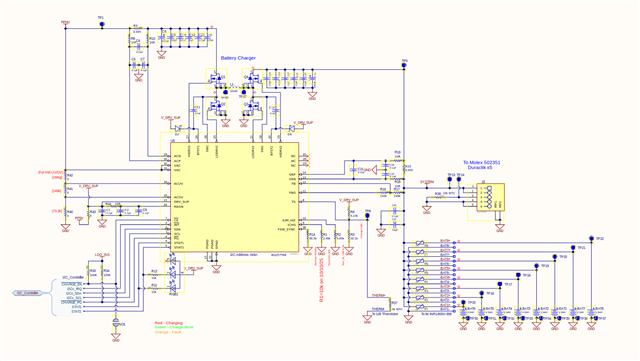

I have the TPS25751DREFR connected to the BQ25756E.
The charge status status it is under fast charge and the STAT lines display a charging state but no current is flowing. All the status registers are clear with no faults.
Charge enable is active and the power good signal is active.
Would much appreciate any help or direction!
Thank you

  • Hello Drew,
    Thanks for working with this. I have a few questions to help debug this.
    • Are you using the EVMs or a custom board?
      • If you are using a custom board, can you send me the schematic?
      • Have you made any adjustments to the EVM?
    • What's the input voltage and the battery voltage?
    • Can you read the status and flag registers of the BQ25756E?
    Ethan Galloway
  • Hi Ethan,
    This is a custom board.
    Input voltage can vary since this is connected to the TPS25751D. The TPS is configured to enable the CHARGE_EN when it starts up.
    I realized that the status and faults are cleared after the first read so therefore there are some indications.
    So, the DRV_SUP has faulted and the input under-voltage flag has faulted.
    DRV_SUP measures at 4V and Vacuv is shorted to PPHV on the schematic.
    Battery Voltage is at 3.64V currently.
    The config for the TPS is above.

  • Hello Drew,
    Thanks for working on this.
    There are a few things in the schematic that could be improved:
    • The BTST capacitors will need to be 100nF.
    • If the system isn't using ACUV/ACOV, you'll need to short ACUV to VAC and short ACOV to GND.
    • The system will need to have the capacitance balanced across the sense resistors. You can see this FAQ for more information.
    • Can you send me the inductor and FET datasheet or part numbers? I want to make sure that these parts will work with the BQ25756.
    • I recommend only connecting DRV_SUP to either PP5V or REGN. Shorting DRV_SUP to REGN may make initial testing easier.
    Ethan Galloway
  • Ethan,
    Thanks a ton for the help!
    We currently have ACUV shorted to VAC and ACOV shorted to GND.
    We changed the BTST caps to 100nF and shorted REGN to DRV_SUP with no change.
    I am still getting the same results from the BQ25756E registers.
    FETs: SQS482EN-T1_GE3
    InductorSRP1510CA-100M
    Please let me know if these parts don't seem adequate!
    Thank you!

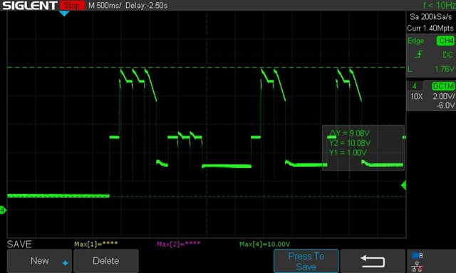

  • Hi Ethan,
    Thank you for the reply.
    We made a little bit of progress here. I wired in a power supply to VAC in an attempt to isolate the issue and I was able to charge the battery with 15V input at 15A to the battery.
    Now, when I try to use the TPS to deliver more power from PD, I get some faults. Below is VAC. This is negotiating from 5V to 9V and then seems to be resetting. The CE pin is shorted to GND.
    This is a different USB PD plug:
    After this happens, I get these flags:
    Charger Flag 1 = 0x41
    Charger Flag 2 = 0x80
    Fault Flag = 0x02
    And then:
    Charger Status 2 = 0x80
    Hopefully this helps.
