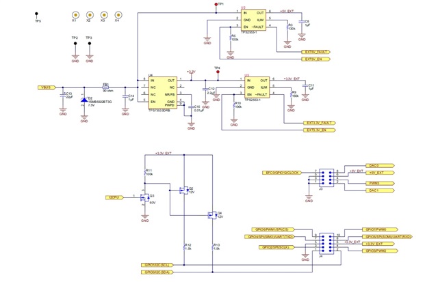

    Many thanks for your reply. I am attempting to connect the GUI to my custom board with the USB2ANY module. I have confirmed this afternoon that the possible reason for not having comms (there is no I2C comms) is that the output switch of the USB2ANY (U5 on the USB2ANY schematic) is not turning on.  This is controlled by the MSP430F55291PNR, isn't it? If so how does the GUI tell the USB2ANY to turn on its 3v3 output, and/or select its 5v output? I can't see anything in the available functions of the GUI that has this control over the USB2ANY module, although this may not be the cause of the lack of I2C comms.
    I have a separate 3v3 pullup source on the board.
    kind regards, David.
  • Hi David,
    Thanks for the info here.
    The GUI actually isn't interacting with the 3.3V pin of the USB2ANY at all, the SDA and SCL should be pulled up by your external 3V3 pullup source, so the USB2ANY's 3.3VEXT output is unused/not needed.
    As seen from our EVM schematics, pin 5 of the USB2Any adapter isn't connected:
    Would you mind showing how your board has the USB2ANY connections set up?
    Sarah

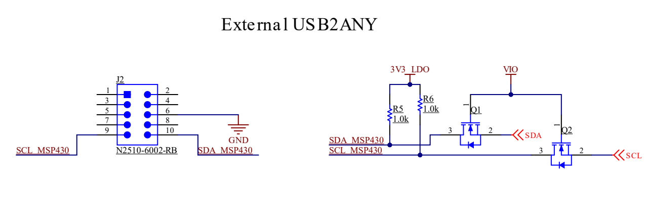

  • Hi Sarah,
    Just to be accurate, I am using the USB2ANY module to connect to the TPS6521905 on my board, not the EVM, and the interface schematic for this is....
    This circuit does look like the MSP430F5529 has some control over the I2C interface, and is able to supply 3.3v output, but if the I2C lines still communicate whether or not this interface is setup, then that should be fine.
    So my circuit looks like this...
    and at the moment I can see the SCL and SDA lines are high at 3.3v, but there is no activity on them when I attempt to attached the USB2ANY module to my desktop running the 6521905_GUI. To my mind, the fact the GUI attempts to link to the USB2ANY but fails suggests there is a problem with the desktop talking to the MSP430F5529 on USB2ANY module rather than a problem with the I2C link to the PMIC.
    best regards, David.
  • Hi David,
    Thanks for your response,
    It looks like J44 in your schematic is the output to connect to the USB2ANY module.
    Are you just connecting these individually with female-female wires to the pinout of the USB2ANY module?
    J44 and J45 don't appear to be formatted as a 10 pin header for the ribbon cable.
    Are you able to show a picture of how the module is physically being connected to your board, just so I understand?
    I'm concerned if the pin-outs aren't matching correctly.
    To further ensure this isn't a GUI problem,
    Can you also try running the USB2ANY explorer, check that your USB2ANY module is running the latest firmware,
    attempt to pull up the 3.3V ON and see if I2C is acknowledged?
    Sarah

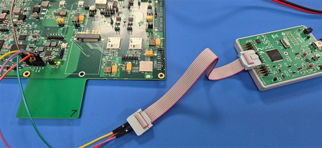

  • Hi Sarah,
    Yes, indeed, J44 is the connector for the USB2ANY module and I use female-female leads for that.
    I will send you a picture tomorrow when I am back in the office and I will also check the firmware with explorer.
  • Hi Sarah,
    Many thanks for the USB2ANY explorer suggestion, updating the firmware now allows the TPS65219_GUI to see the USB2ANY. However, the GUI now fails on being unable to talk to the TPS65219 device itself with error message "Connected to USB2ANY Controller, but failed to connect to TPS65219x on I2C @0x30"
    0x030 is the correct I2C address for my device.
    Here a photo of my setup...
    You may just be able to read that the SCL wire is connected to pin 2 of the USB2ANY module via the red wire, SDA to pin 1 via the yellow wire and GND to pin 5 via the purple wire. There is 3.3v on the board pulling up the I2C lines via 4.7K resistors. I cannot observe any activity on the I2C nets on my scope.
  • Hi David,
    Thanks for the update, it looks like those pin connections are fine,
    When you say no activity on the I2C lines, are these just constantly high?
    If you just use the USB2ANY I2C tab and attempt to read or write, does this show any activity on the SDA or SCL lines?
    The "failed to connect to TPS65219x on I2C @0x30" error message doesn't necessarily mean an address issue, this could also indicate a hardware connection issue, that it is not connected to the PMIC correctly, and not able to detect it properly.
    Double check all your connections, and make sure there aren't any faulty wires or cables.
    Sarah

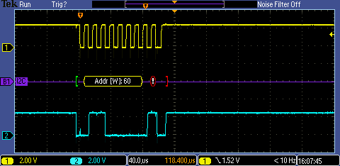

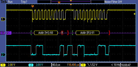

  • Hi Sarah,
    I definitely have 9 vias on the thermal pad.
    Here is an attempted write...
    Here is an attempted read...
    numbers that I enter into the internal address box or write data box do not make any difference to what is seen on the I2C lines from these 2 images.
  • Hi David,
    Thanks for the scope shots, I see this is receiving the NAK error even though lines are active. .
    If you measure any of the other PMIC outputs, is this measuring as expected?
    I am not sure of what test points you have available on your board, but are you able to check VDD1P8 is regulating correctly?
    I can only think of perhaps the PMIC was damaged and is not turning on properly, causing the NAK.
    Sarah
