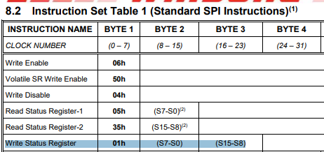

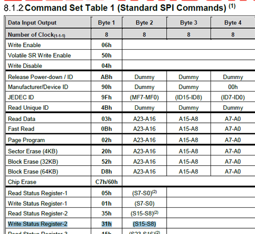

    * Difference 1 : Write way to status register-2
    memory which is implemented EVM
    New memory
    * Difference 2 : Initial value of status register-2 (Bit 2 and Bit 1)

    Actually, it seems that above program does not access to 0x01 (write status register)
    For W25Q80RVSNJQ(new memory), there is following difference about "Initial value of status register-2" (Bit 1)
    For W25Q80DVSNIG(Implemented on EVM), this bit is set as "0" in default. (This means disable quad SPI mode)
    However, for W25Q80RVSNJQ(new memory), this bit is set as "1" in default (This means enable quad SPI mode)
    Is there anyway to add code which change default vaule of status register on Application customization tool ?
