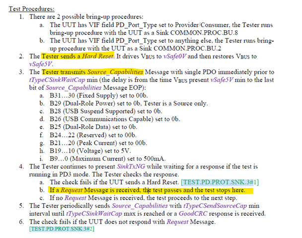

We are trying to pass the USB-IF certification as PD 3.1 with a TPS65987DDK on a GRL C2
We solved most of our issues, but there still are two tests that we can't pass.
TEST.PD.PROT.SNK.3 SinkWaitCapTimer Deadline - Incomplete :
From my understanding, the tester sends a hard reset, and then sends its source capabilities just before the tTypeCSinkWaitCap minimum (310ms), then the TPS65987DDK should not send a request, but does it anyway.
TEST.PD.PROT.SNK.4 SinkWaitCapTimer Timeout - Warning :
Here, the tester sends a hard reset, and then doesn't sends its source capabilities. The TPS65987DDK should send a hard reset after 620ms, but sends it a bit later, between 645 and 650ms, which gives a warning on the test.

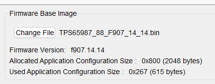

    The json file did not load.  Also, in the pjt there is no firmware information.  Can you confirm you are using F907.14.14?
    Chris
  • Hello. I don't know why the json file doesn't load.
    We are using F907.14.20 as suggested here.
    This interpretation does not appear correct.
    The PD controller is programmed to wait about 607ms.  I am not able to follow the trace log, which shows greater than 1s.
    Can you inquire with the test house the interpretation?
