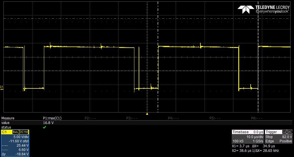

The design uses an LM25190 to provide a 12 V / 8.3 A power supply, with an output adjustable from 0.9 V to 12 V.
When the load increases to around 7A, the output switching frequency drops to about 20 kHz. What conditions could cause the IC to reduce its switching frequency?

    Can you please provide operating conditions and schematic to comment further? One possible case would be drop-out mode.

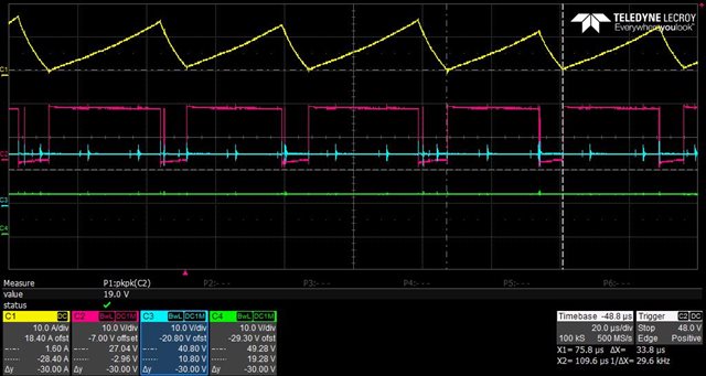

    5.The waveform during the frequency drop.
    CH2: LOW SIDE VDS
    CH3:Vin
    CH1: inductor  Current
    CH4:Vo
  • 1. Inductor current waveforms do not look linear to me, what is the saturation current rating for the inductor? As already asked, please provide datasheet of the inductor
    2. It does not look like over current protection has been triggered a
    3. As replacing MOSFETs solves the issue, could you please probe HO and LO?
    4. Kindly try replacing R208 with fresh 240kohms and try connecting RT to AGND and check if the frequency (CCM) is 100kHZ.
