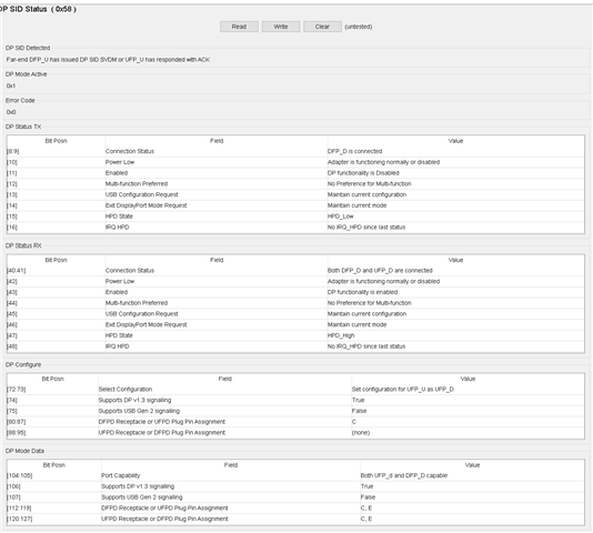

    We have made some progress and have been able to capture the following trace:
    We don't however see GPIO3 (HPD) go high, when this is set as a alt mode event, are we missing something here.

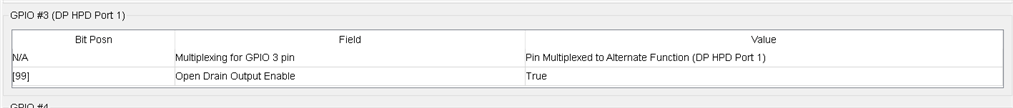

  • Hi Chris
    We have the data status HPD events bit set.
    The GPIO3 is set as:
    Does GPIO3 require an external pullup resistor or is this using a device internal pullup?
    Malcolm
    Please clear the Data Status HPD Events.  This means that you expect the GPIO to indicate HPD instead of the host reading the HPD status via I2C.
    If you configure the GPIO as open drain then yes an external pullup is required.  If not set then GPIO is push-pull.
    Chris
