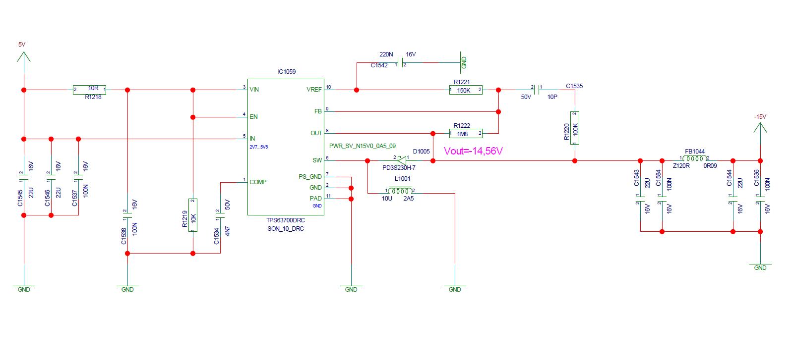

  • Hallo Jeff,
    we've got the same problem in our design. TPS63700.
    If an under voltage condition appears, the device turns off and sometimes it doesn’t come up. The same behaviour at power up process. My collegues has tested an evalboard with TPS63700 and has determined the same behaviour. I have attached a picture with our schematic. Unfortunately I cannot find such a small device.
    Do you know some solutioins for this problem?

  • To attach a file, simply use a paper clip button when writing your post.
    Could you post a waveform (taken on the EVM) of Vin, SW and Vout when the device turns off?  What changes did you make to the EVM to obtain this waveform?
