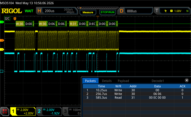

for my BMS under Development, I am using the bq7693007 to balance the 10 Cells.  So this BQ has an ID Address 0x18, as on the Datasheet page 3 (Product Folder Links: BQ76920 BQ76930 BQ76940)
I am using PIC32 to interface woth BQ through I2C that was set at 100kBit.  I then tried to interface with the BQ, no answer dispite the Address 0x18 is well shifted one bit to the left for Write (and shifter 1 bit left +1 for Read).  But the BQ does not answer.
Then I looked to the Website of the BQ76930 Component at TI.com and found that Example under BQ76930EVM then "SLUC583 — bq769x0 I2C Sample Code With CRC" that helps much.  So I adapted the Functions to Write Byte, Write Bytes, and ReadBytes from MSP430 µC to my PIC32 µC.
Under Function "int main(void)" found in file main.c I see that Function InitialisebqMaximo(); and Result = UpdateVoltageFromBqMaximo(); to read the VCell1, as in the File bqMaximo_Ctrl_G2553.h at line 801.
So I intialize my I2C (with the PIC32 Setting), I set BQMAXIMO = 0x18, I itialize my BQ with the Function InitialisebqMaximo(); and then I read VCell1 with the finction UpdateVoltageFromBqMaximo() in a loop.  In the loop I have this UpdateVoltageFromBqMaximo() only.
On the Oscilloscope, here attached the Graph, the I2C RigolDS31.pngdecoder seen Write:30 (which is 0x18 shifter left 1, correct) and Read:31 (which is 0x18 shifter left 1 +1, also correct).  But nothing was red?  I read nothing, and why?
Something wrong, I measure on pin 8. REGOUT of the BQ76930, 1.5V only but why not 3.3V.  Is BQ damaged?  Or because it is not connected to the Battery Cells?
Please help me with this, it is my last Problem with the BMS Board.

  • Hello Dr. Ayadi,
    The REGOUT powers assorted internal circuitry, including the communication buffers and coulomb counter which could explain why you are having communication issues. What specific BQ76930xx device do you have? Depending on the specific device, the REGOUT is expected to be either 2.5V or 3.3V. Does it have ~1uF capacitor on the pin? Is there any significant load on the REGOUT pin?
    Is the CAP1 pin reading 3.3V after booting up the part?
    Alexis

    thanks for the replay I was worried about this issue.
    the used BQ ist bq7693007, that should make REGout 3.3V, but I measure 1.5V only.  I checked my measurement done on that Pin some weeks ago and it was 3.3V, and when I reset the BQ on Pin TS1 at 0V, REGout was gone to 0V too, very normal.
    Maybe this IC is brocken when I was prototyping on its I2C last week, so I will remplace it tomorrow.
    On Pin REGOUT I put 4.7µF, no much load on the Path, I just power a logic OR with it.  I know it can deliver just 50mA max.
    I measure also 1V only on Pin7 CAP1, but it should be 3.3V, right?
    I still have one new BQ left, if it get burned too, I will need to buy 5 more from mouser.de and 20€ delivery cost, not good.
    Also, from that read function Result = UpdateVoltageFromBqMaximo();
    I send the value of "Result" on my PC, I read -1V.  That is the Cell1 Voltage, but the BQ is not yet connected to the 10 Cells, an I don't understand why -1V if I2C does not show any replay from BQ. May be the Initial Value or what.
    I will connect the BMS tomorrow with this brocken BQ to the Cells to see if any fire errupts.  If every thing ok, then I can solder the new and last BQ.
    Also, looking to the Graph from the Osci. why it makes 2x Write and 1 x Read? strange really!
    Talk to you tomorrow hopefully with positive result,
    Kamel Ayadi
  • Hi Kamel,
    I hope you had better results.
    That is correct. If it's not reading 3.3V or 0V (when device is in shutdown), there is a chance that the device is damaged.
    I'm a little confused from this comment. You tried to communicate with the device while it was powered off and read -1V? I would expect the device to have NAK'd since the device was not even powered on. Do you have any other devices on the same I2C bus line?
    Please be careful.
    Is there also a reason you are also using our BQ76930 device versus one of our newer devices such as the BQ76952?
    Alexis

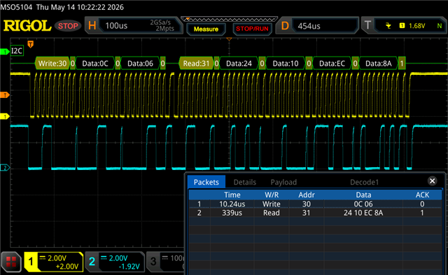

  • Hi Alexis,
    (could you make this conversation not visible to non-TI, because it is Product and we won't share our Technology with the others, thanks)
    Now, thanks for introducing me the latest BQ76952, I will read its Datasheet and I will replace the BQ76930 with this new one if it fits with the Lithium-Batteries, in the next Tape-out by next month.
    Please stay with me on this issue, I am in the way to solve the Problem, as many things are already explained and solved and the Device works now just fine, but I am strugguling with the Firmware for the Read and Write, as follow.
    I connected the BQ to the Battery Module of 10 Cells Serial and I measure REGOUT 3.3V and CAP1 3.3V, means the BQ is in full function, also the BQ answers tho my µC through I2C and with Bit Knowlage (NAK) at 1 in green on the Decode of the Osciloscope.
    Now struggling with the Firmware (FW) Alexis, you know TI has that FW Example "bq769x0 I2C cCode with CRC", here attached the TI Files (main.c and bqMaximo_Ctrl_G2553.h) to configure the BQ76930 and then in the loop it makes the Read of Cell1 Voltage and stores the Value in the integer "Result".
    My Problem, is that I am not familiar with µCs from Texas Instruments, so I must adopt the Code with the Read and Write of PIC32, I am good with PIC32 but not MC.
    Then I integrated the two Files from the Example in my FW Project, and I must adjust the 3 Functions (Write one Byte, Write Bytes, Read Bytes) with my Write and Read Functions of Pic32.  With my effort on that, I compile and flash the Firmware and I have activated ones the BQ Configuration Function called InitialisebqMaximo(); and I observe on the Scope I2C.
    Attached is what I get on the Scope and I know my Write and Read are not fine in the Functions found in main.c and called:
    int I2CSendByte(...
    int I2CSendBytes(...
    int I2CReadBytes(...
    Could you help me just for these three Functions, if I can show you how I integrated my Read and Write in them? they are here attached under app_i2c.c and app_i2c.h
    I need help just for the 3 mentioned Functions above and I am 99% sure the first one is fine, but Write and Read multiple Bytes is my Problem, thanks for the Support.

    Now when reading from this following Function in a loop:
    I get these Graphs and the last Byte of the Read is changing.
    I don't have a reference, like the correct Pattern of Pulse of the Read.  If I have, I could fix myself the Read and Write of Bytes Functions and make this Read correct.
    I don't know, what the Patterns of Pulses should be, please support me with this, I won't work by guessing!
  • Hi Kamel,
    Please give me some time to review what you have shared and capture some waveforms on my end.
    Alexis
