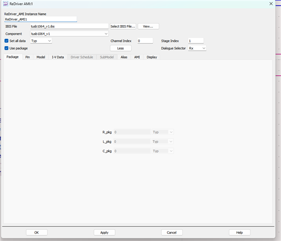

    Let's get back to TUSB1064, We are using a cable for simulation and found that the eye diagram result is poor. The TUSB1064 has equalization, and we would like to adjust the eye diagram result through this equalization. However, we do not have this simulation file at present. Could you please send us the simulation file for adjusting the equalization?
    BRS,
    Frank
  • Hi Frank,
    The IBIS AMI file can be found here: https://www.ti.com/product/TUSB1064#design-tools-simulation
    This IBIS AMI file works with the Keysight ADS software. I will be using the 2023 Update 1 release version.
    Here are the stesp:
    1) Open IBIS AMI file. This can be done by creating your own schematic or using the pre-built archived file (.7zads). I will be using the pre-built schematic.
    2) Double click on the ReDriver_AMI block.
    3) Select the AMI tab and click on EQ RX AMI parameter:
    4) The default EQ setting will be 0. to manually adjust the EQ deselect the Use 'Set all data' setting, and adjust the Selected RX AMI parameter to user specified.
    5) Manually adjust the EQ and click apply.
