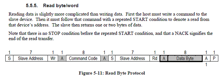

  • Hi Eric,
    We are currently trying to read specific registers in the UCD device.This is the approach what we took:
    void Check(unsigned char Dev_Add,unsigned char Reg_Add)
    unsigned char Value=0x00;
    i2c_start();       // i2c starts
    i2c_write(Dev_Add);   // Device Address, in our case 0xC0   <==  (1)
    i2c_write(Reg_add);  // Register Address, in our case 0x27  <==  (2)
    i2c_start();    // Repeated Start <==  (3)
    Dev_Add=Dev_Add | 0x01;  // set 8th bit as read bit,     <==  (4)
    i2c_write(Dev_Add); // Address set to 0xC1   <==  (5)
    Value=i2c_read(TRUE); // Read Value from the register; TRUE sends acknowledgment from Master to Slave. <==  (6)
    i2c_stop();
    Now, we are monitoring the waveform through CRO, and observe that in statement (1), we are getting the acknowledgment.
    Next in statement (2), we are again getting acknowledgment.
    Now, since we ORed the address with 0x01, we get 0xC1.
    I - Now our point of concern is that at statement (5), we get the waveform for 0xC0 and not 0xC1. Also no acknowledgment was received.
    II - Also at statement (6), we get data as 0xFF which means no data was received. Also no acknowledgement was sent from master to slave.
    Now, we need to resolve the issue I and II. Please let us know where the things are going wrong and whether there needs to be a change brought up in the steps/ approach taken.
    Nipun
  • Hi Nipun,
    I'm pasted the SMBus spec which should be used for Reading byte/word. You should be doing 0xC0, 0x27, 0xC1 and you can get the device ID as 0x41 for UCD9080 and 0x55 for UCD9081.
      Thanks, Spandana

    The UCD9080 makes use of clock stretching if your master code allows for that. your I2C master must poll the SLCK line and it can only drive the SCLK line low once it's high; the UCD9080 will keep the SCLK line low if it needs time to perform its work. The master cannot clock the UCd9080 without regard to its state.
    Thanks, Spandana
