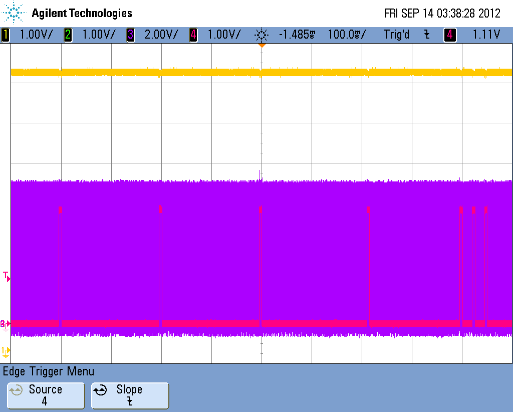

    Next time it fails, just capture a waveform of Vin, Vout, SW and SYNC.  Then, capture a waveform of those same signals when SYNC is taken high again.  Finally, a waveform of normal operation with SYNC toggling would be good to see now so that I have a clear picture of what you are doing.

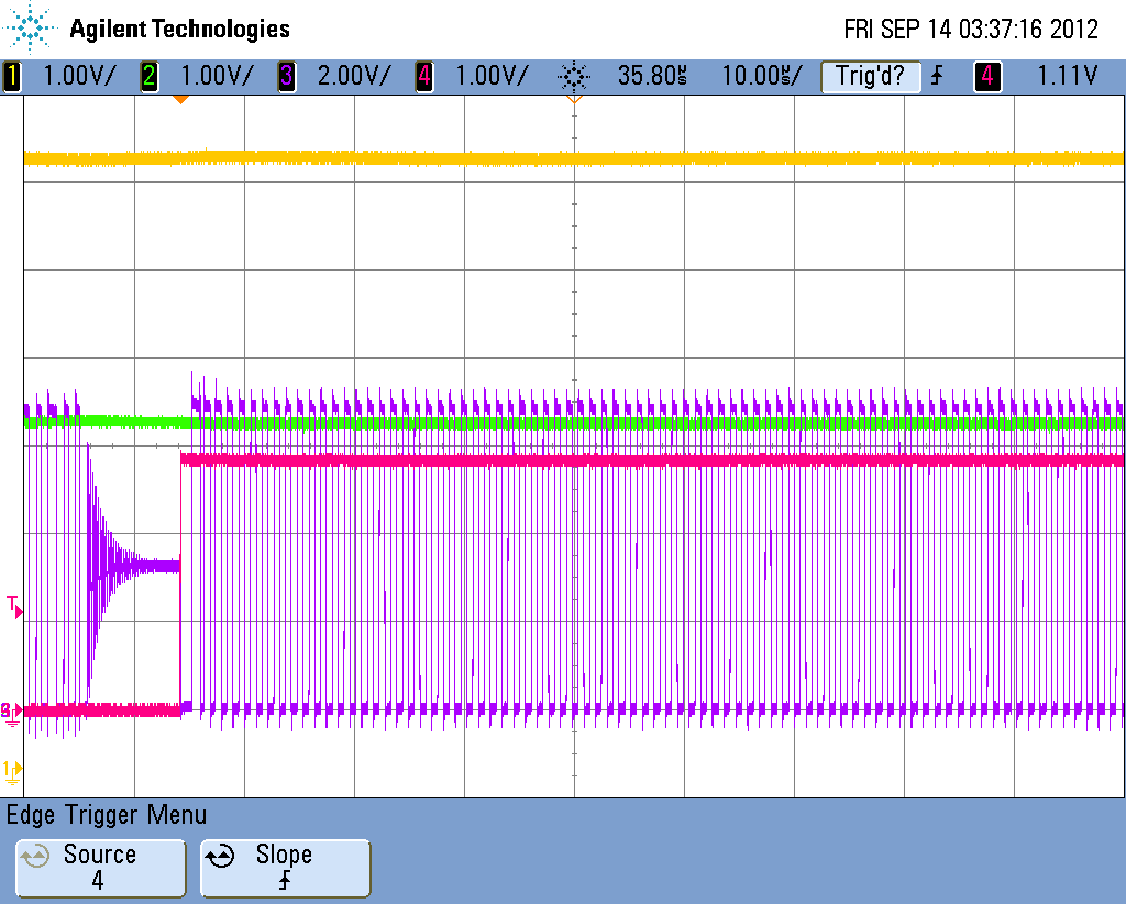

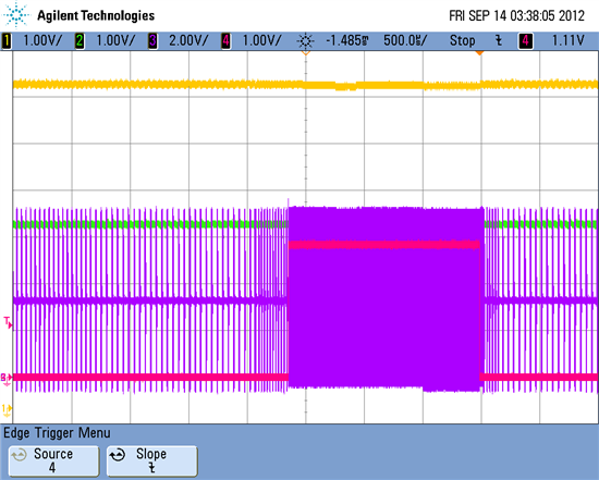

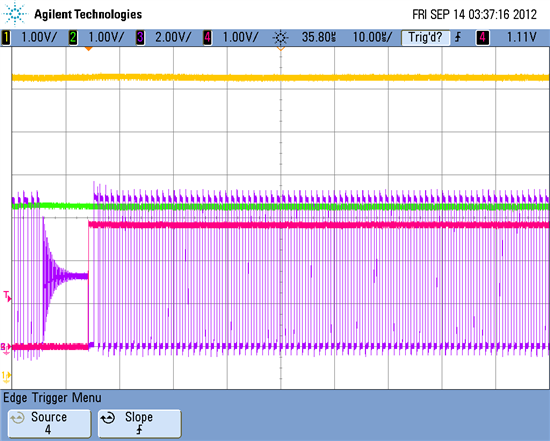

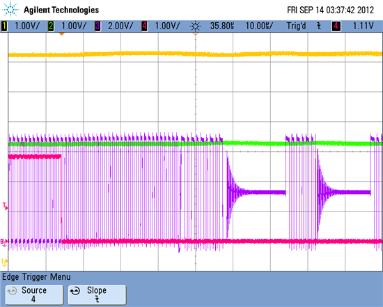

  • Hi
    Here are the signals on normal operation of our product.
    CH1 Vin
    CH2 Vout
    CH3 SW
    CH4 SYNC

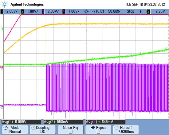

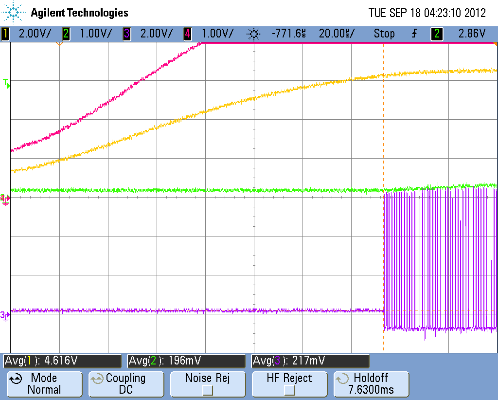

  • Hi
    The units that are failing are with the customer, we cannot wire them to see when they fail, we can wire units in our lab and Hope they fail
    Removed R194, SYNC pin is now stable hi (same as Vin), unfortunately this did not wake up the switcher.
    As I did not see anything else to do, I power cycle the unit and came back alive, find attached the wakeup sequence captured
