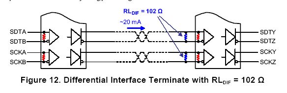

  • Hello Cristian-san,
    Thank you for your reply.
    It seems communication error.
    Could you let me know wire length between IC to IC for differential?
    If IC to IC is long distance, it needs termination resistor of 102ohm on DATA+/- and CLK +/-.
    This is on application note on below URL.
    http://www.ti.com/lit/an/sbva036/sbva036.pdf
    If you can send photo and schematic,it's helpful for me.
