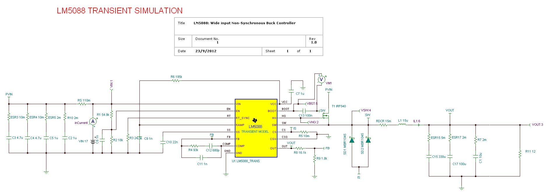

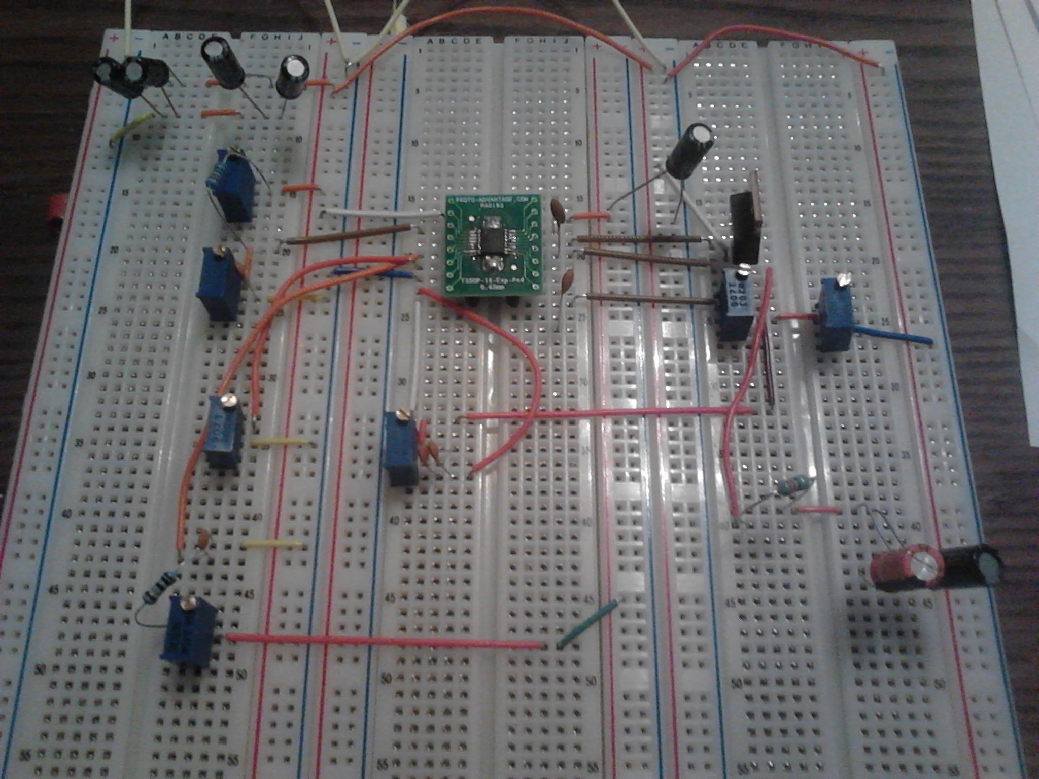

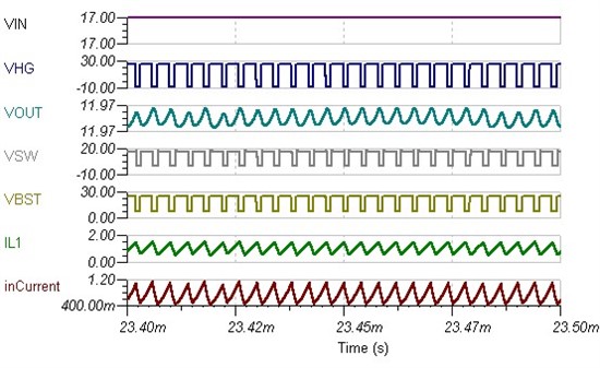

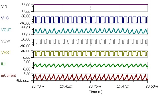

Hi. i'm a student working on a project. i have the LM5088 buck controller. i connected all the parts according to the simulation on Tina and the calculationg xcl.file to get a 12v output Voltage. every thing seems ok on the simulation, but actually it doesn't work. i need your help to understand why is that. and which steps should i take to find the problem.by the way, i connected all the parts on a metrix as shown (it's not all the parts but it's just to show the basic design). i am using parts that are all T/O. the connection of the LM5088-1 is by an adapter to dip. i tryed testing it on the lab, connecting an electronic load. i've tryed ajusting the load from 200 ohms and going down. another thing i've tryed was to connect it to a power supply that gives minimum of 0.03 Amps and i played with the Iin and Vin. still have't got any result.

    I think you might be able to make the board start switching, but it will be very hard to make it working properly. It is recommended to buy a LM5088 EVB from TI's home page and then modify the board if you want.

    why is it hard to make this board working properly? is it an issue of cables and noise ?

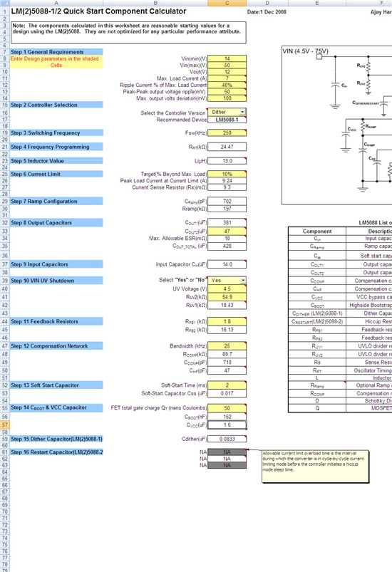

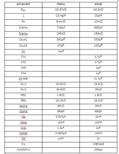

    i am using parts that are calculated by the  data sheet,
    first can u look at the parts i calculated and tell me if they are suitable for my plan? can you advise me which values should i try to change if any?
