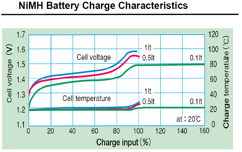

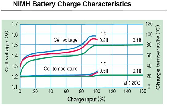

  • Thanks Ed. A few more questions about the BQ2000T if you would:
    Is it OK that 7S NiMH cells get programmed (via the resistor divider)  for 14.1V even though they're full at 11.2V? The idea is that the dT/dt mechanism will terminate charge. Is it safe?
    If we do that, what will cause teh chrager to resume charging?
    What is the mzimum duty cycle for the BQ2000T?
    -Tim Starr on behalf of JK@NM
  • The resistor divider is to detect Over Voltage.
    When no cells are in place, the charger output will go high, indicating there is no load on the charger.
    As a pack is inserted the charger output will transition below the OV point and tell the charger to start.
    A bad cell could be high impedance, so OV also prevents charging a pack with bad cells.
    You expect the max cell voltage for NiMH to be 1.6V/cell.
    A good NiMH will terminate BEFORE THAT.
    dT/dt temperature termination is a little better for NiMH because their -dV/dt full charge slope is less than a NiCd.
    dT/dt termination for NiMH is widely used.
    Once a proper termination has been determined, to start a new charge:
    1) cycle input power to the charger (reset)
    2) pull out charged pack, output sees OV, put discharged pack in, pulls output below OV.
    A charge of C/2 (0.5) or greater must be used to force the chemical reactions for Temperature Rise, and -dV/dt.
