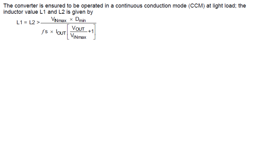

    We ran some numbers and it appears that, in order to maintain a ripple current above 0.5A, both the 15W and 2W designs would run in DCM, according to the following equation from SLVA442 document:
    How do the various equations change for DCM since most of them seem to be based off of assuming CCM?
    Doesn’t operating in DCM result in higher noise due to ringing on the switch node as the inductor current decays to zero?
    How does one go about compensating for a design that sits in DCM?
  • Hi Paul,
    I don't have a rule of thumb but it requires a very low power application for this to be a concern. If it is an issue a gate drive resistor can be used to reduce the current for turning on the FET in most applications.
    What are the input and output voltage/current requirements for each design? Depending on these I expect it will make the most sense to do a CCM design for the 15W.
    You are right DCM does have the additional ringing. This could add some more noise to the system. But I say DCM can have better efficiency for the lower power design because it will allow you to use a lower inductance which is typically is lower DCR.
    Compensating for a SEPIC topology is not the simplest to design for with calculations because it is challenging to model and simulate. Typically calculating the values using the equations for a Boost design will give something which works and with testing a real circuit you might find it needs to be improved or works as needed. As for compensating in DCM, with current mode control a design which is stable in CCM should be stable in DCM.

  • Hi Paul,
    Hope you are enjoying the holidays!
    Do you plan to use a coupled inductor in your application or two seperate inductors?
    If you plan to use a coupled inductor, taking a look through you're spreadsheet I found there is an error using Equation 7. It is missing a factor of 2 in the denominator to account for the decreased ripple when using a coupled inductor. This cuts the minimum inductance for CCM operation and the minimum ccm current in half.
    Looking through some previous designs, the lower power SEPICs with the TPS40211 (or TPS40210) have been designed for CCM with an inductor value in the hundreds of µH. Too little ripple should not end up being a concern. For examples please take a look at PMP2778 or PMP5908. These designs use a 10 and 20 ohm gate drive resistor reducing the current when turning on the FET.

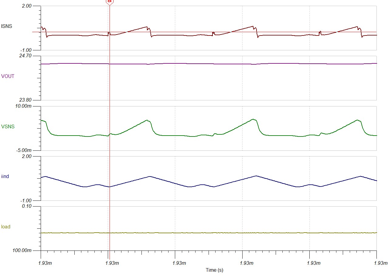

    I originally overlooked that the gate drive resistor helps to reduce the peak current during turn on of the low-side FET. The filtering does also help to reduce the spike in voltage at the ISNS pin. The other application had an issue with this because the higher voltage FET would turn on too slowly if a gate drive resistor is used. The larger FET also required more current to turn it on. The size of the gate drive resistance can be selected by testing to see what works. The issue is only seen if the sensed voltage from the peak current from turning on the low-side FET is the same as or higher than the peak current in the inductor. This would case the PWM comparator to inadvertently trigger due to the current at turn on of the low-side FET.
    This current can also be seen in transient TINA simulations. Please see below for an example of this of this. The screenshot is taken with the original boost design and a 100mA load. Notice the current spike is also filtered before it becomes a voltage at the ISNS pin. With 0 ohms the current spike is 250mA and with 10 ohms is 200mA.
    Anthony

  • Hi Paul,
    There isn't a reference TINA schematic available but it may be possible. I tried some but I think the challenge is to have a good model for the coupled inductor to get this to work properly. An ideal coupled inductor causes ringing on the input however the output does regulate. I couldn't find an existing PSPICE model to use as a good starting point.
    Anthony

  • Hi Rustin,
    Attached is the design I left off with. I based it off PMP5910. My goal was to model the coupled inductor as a flyback transformer.
    5367.TPS40210_SEPIC_attempt.TSC
    You will see there is a lot of ringing initially but it settles out. But the inductor current doesn't have the shape I expect when it settles out.
    Anthony
