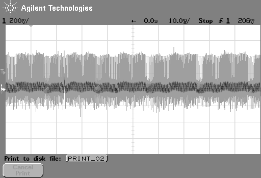

I used Workbench to design a +-30V out, 9-36V in supply using flyback topology, delivering about +-10mA. I need low ripple, because I use this supply for OPs (OPA454).
Basically the circuit is working, giving +-30V, enough current, no heating, but, also a lot of ripple.
The ripple voltage is depending of the input voltage, 9-21V, its about 100mV, and low frequency, 21V-24V ripply amplitude jumps up to some hundrets of millivolts, at 24V amplitude drops and frequency rauses, at 28V its quite nice.
Any idea? I add a big capacitor to the output, but no change.

    As far as I can see, this noise is caused by oszillations of the control loop.

    Shots:
    9V in, 30 V out at 10mA
    28V in, 30V out at 10mA.
    I used as electronic ballast, but I also tried it on a pure resistor. The scope is AC coupled and no BW limit.
    Thanks for helping.

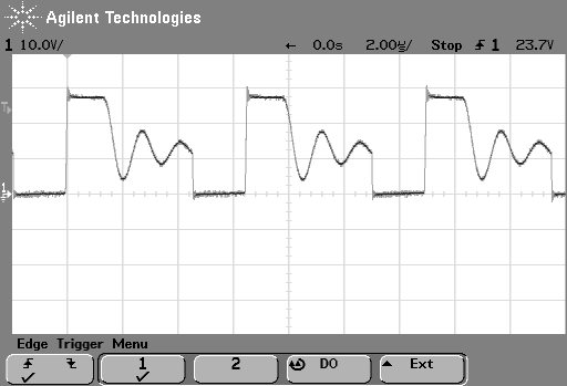

    Marc and I just discussed a few aspects of your design. First a cautionary note. If you are using a 1:1 turns ratio from primary to secondary the the peak swithc voltage will 30V + 36V = 66V which is right at the rated switch voltage limit for the device. But I haven't seen your schematic yet to see if this is the case. The second thought is that the rated switch current of hte LM2588 is 5A which os much larger than you actually need. My initial thoiught is to recommend the LM5000 product, which would be a better match to the application, but it is in a very different package if that matters.
    I think the output ripple you are experiencing is due to that fact that the application is very lightly loaded compared to what it is capable of producing. As a result, it is skipping cycles. You might try adding a small feedforward  capcitor in parallel with the upper feedback resistor to see if that helps. (100pf to 1000pF as a starting point.)

    here is the potential at SW:
    Here the voltage at SW pin. Doesnt exeed 30V, hope that is within the margins.
    The transformer is a universal inductor having 6 equal coils. Two of them in paralell were used for the primary winding and the other four, two in series, were used for the two secondary windings. Hope this gives the planned ratio of 1:2.

    I tried out 470p amd 1n. With 1n paralell to R3 (upper feedback resistor) the output is quiet, 20mV ripple at 0mA load. As I add the load, the ripply is quite high, some hundrets of millivolts?? Using 470pF only solves the problem for higher input voltages. Inputvoltages smaller than 14.5V giving the same ripple with or without capacitor.
    I decide to add 1n2, which I have as 0805 SMD and can easily piggy packed upon R3.
    After some investigations I found:
    Between 9 and 13.1V input and my load the total output is 59.998V and ripple ~50mV, but high frequency, so DMM integrates it out.
    Between 13.2 and 14.9V input the ripple is some hundred millivolts, which gives uncertain readings of the voltage, but it must be something around 60.2V
    Between 15.0V and 28V input the output is 59.998V again and ~50mV ripple.
    The ripple is mostly like a square,  frequency is 250kHz.
    I guess, that after adding the 1n2 capacitor, the compensation network has to be fine tuned. Or am I totaly wrong?
