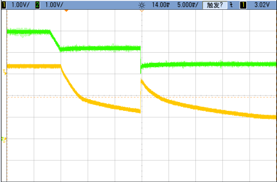

  • Hi,John.
    I met the same problem with Todd,I'm trying to set the voltage divider to turn off the TPS54331 when the input voltage drops below a threshold. It Seems to be no UVLO where the switching should turn off completely when Vin falls below a certain threshold,but reopened after about 15ms actually.Values used in my circuits are Ren1 =100k , Ren2= 39k,and Vstart = 4.35V and Vstop =4.05V. This is the power down sequence,the green line is the waveform of Vin,and the yellow line is Vout.
    Could you give me some suggestion about it?
  • I t looks like your VIN is rising back above the threshold.  I would recommend that you make the start and stop voltages further apart.  I usually like 1 V of difference.
