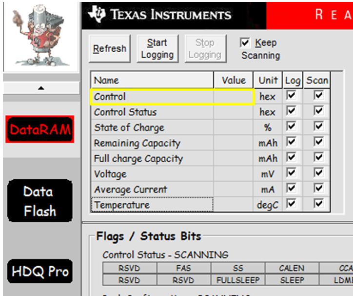

  • Tom,
    4) Impedance Track must be enabled. Enter 21 <enter> in the Control field on the DataRAM screen.
    I don't see the Control Field in the DataRam screen.   How to I enable IT?   Do I need to do it via the I2C screen, or am I missing something?
    - Ross
  • Ross
    Does this help?
    Tom
  • Yes thank you --  I did not realize that you could do writes from there..   I ended up doing it with I2C page but this info will be helpful in the future.
    Thanks - Ross

  • The instantaneous current is available to be read as a Control Subcommand.
