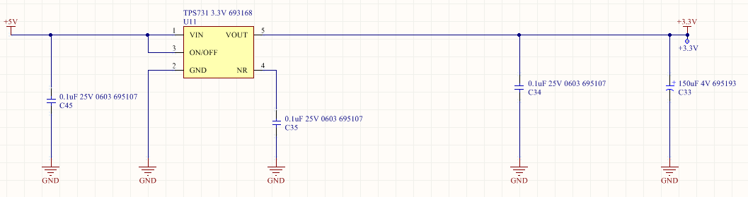

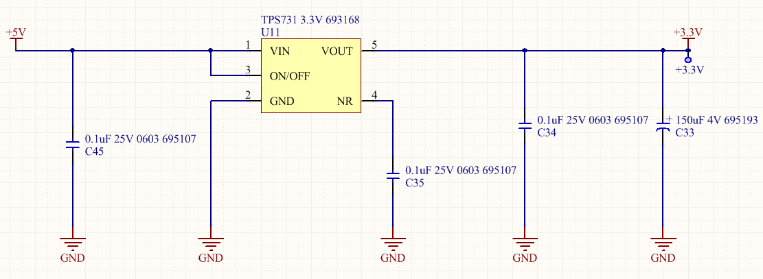

TPS73133DBVR Failure
I am seeing a failure with my 3.3V LDO regulator. I am using the TI TPS73133DBVR and on four prtotyple boards out of 20 the regulator does not regulate it's output.
The input voltage is normally 5V and I have not been able to obseve any over or undershoot on that rail on stuartup or shutdown. Current draw is normally ~75mA which is well within spec of the part
On the damaged regulators if the input voltage is above 1.4V the output is equal to the input no matter wha the input volatge is. This leads me to belive that the feedback loop some how has been damaged. I did notice that I get 170mV on the NR pin of the regulator as opposed to the 1.2V I would expect which could mean the bandgap reference is somehow damaged.
I have a 100nF 0603 cermic capactor on the NR pin would there be any problems with that value of capacitor? What other things could cause such a failure?

  • Hello Kartik,
    The LDOs were operating at room temperature before the failure.
    Here is a picture of the LDO circuit:
    The 5V is supplied by an MC34063 Buck Regulatoe
    I thought about ESD but since we have had 4 failures I find that it's probably unlikley as we have pretty good ESD control in our lab.
    Let me know if you need anything else.
    Thank you,
    Andrew
