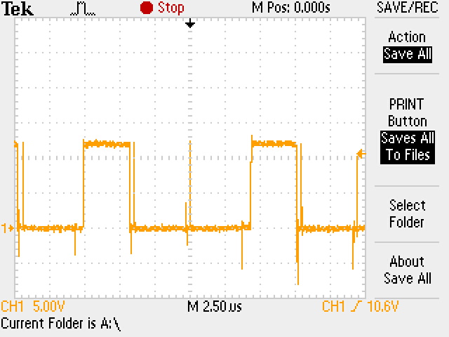

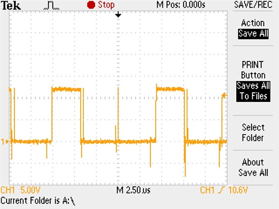

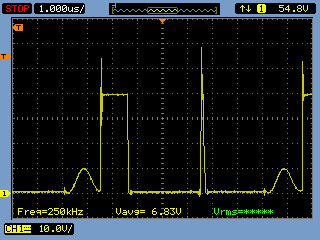

I show here the signals in LO and HO at VIN = 30 V and  VIN = 31.2 V, when is the transition to fail.
LO at 30V is still regulating.
LO at 31.2 V. The pulse in the middle was skipped.

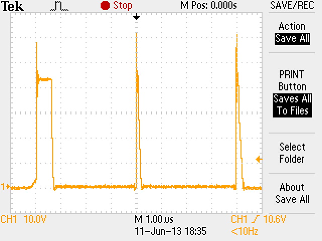

HO, gate of High side mosfet. Only the fisrt pulse is complete.
Note that is NOT the same time scale for all charts.

    I guess that a noise causes such a wrong pulse. Please try a strong snubber.
    Also, replace D303.

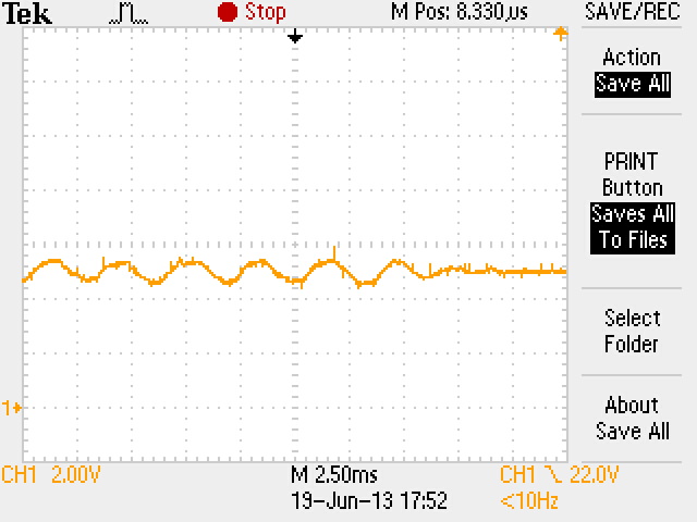

    When the input is around 27 V the output is oscillanting from 4 to 6 V at a frequency of aprox 330 Hz.
    That oscillation is due to the skipping pulses.

    Voltage at the output capacitor due to pulse skipping.

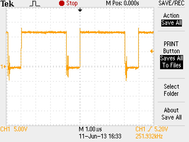

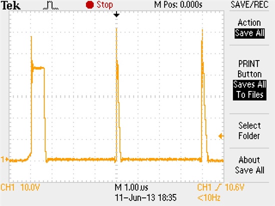

    The signal at HO looks like the figure below. Maybe this signal gives information about of the problem.
    Another problem that I detected is that although I connected pin DEMB directly to the GND in Rs, the LO pin is commutating, while LO is supposed to be always at 0 V.
    When I connect the snubber, the output has oscillations at some input levels, for example when Vin = 27 V, Vout oscillates between 4 and 6 V.
    Fig. 1. Signal at HO. Vin=30 V. No snubber. DEMB at 0V (but LO was oscillating).

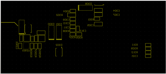

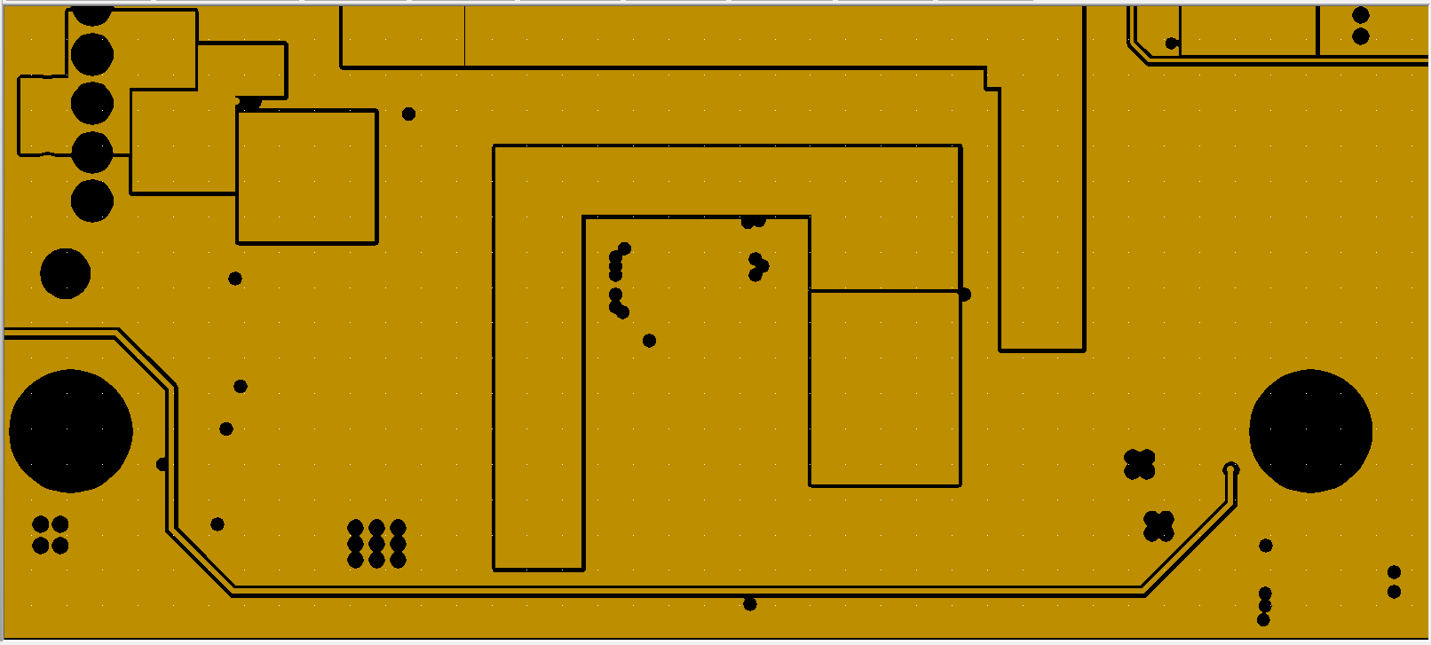

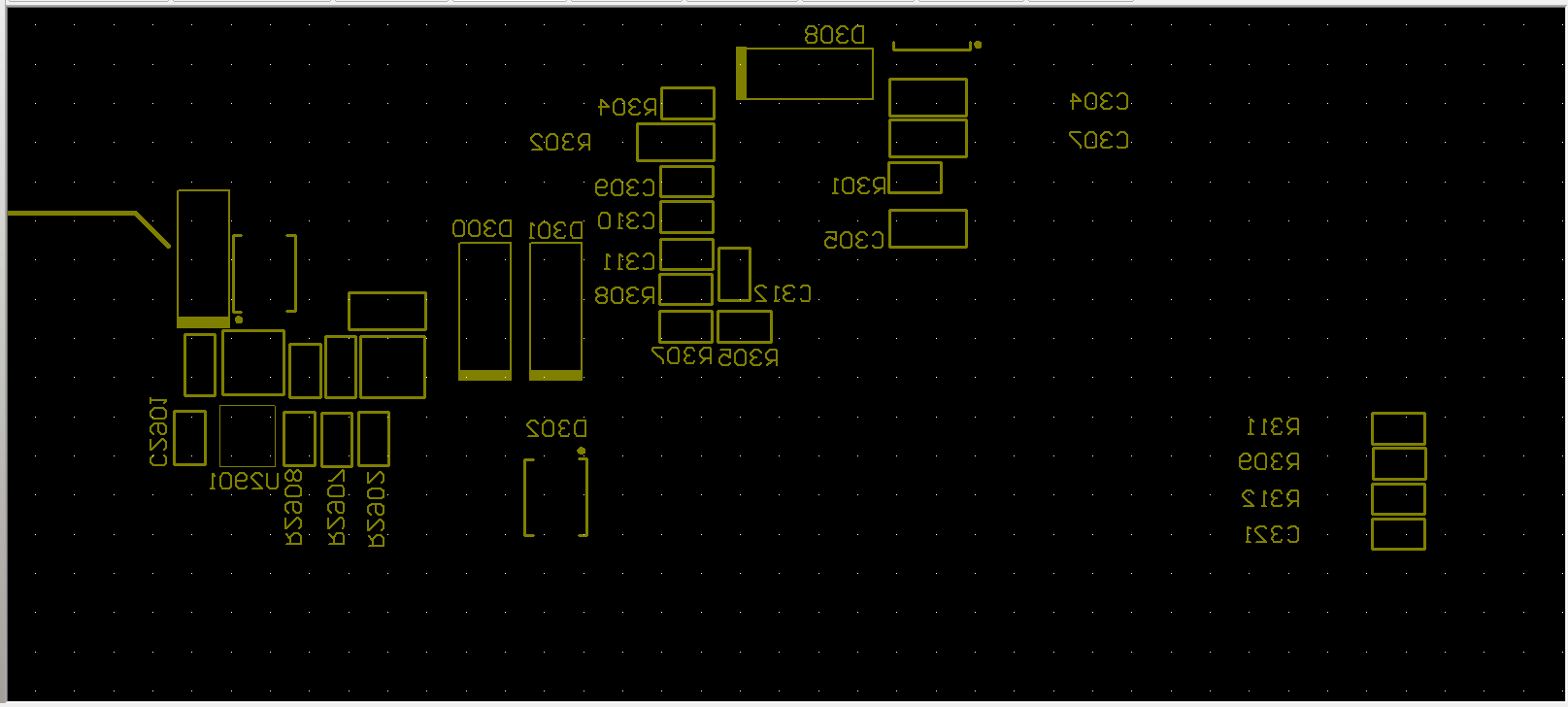

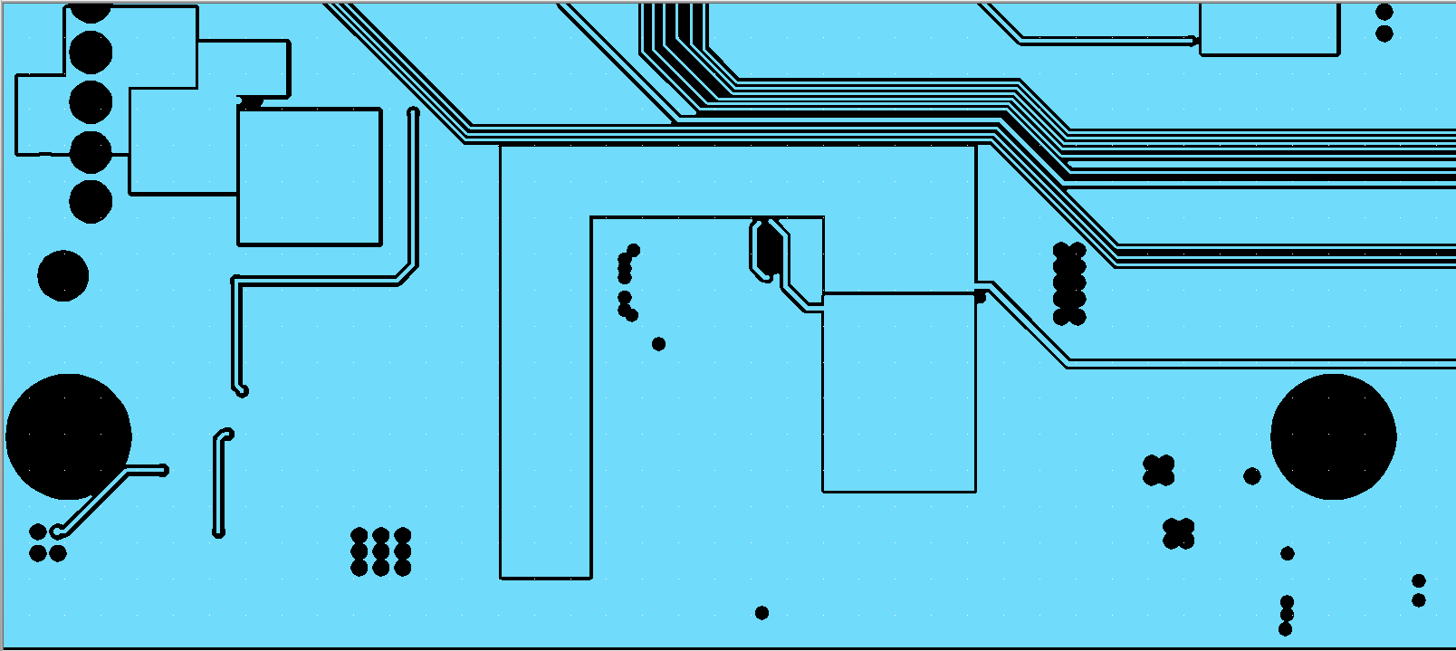

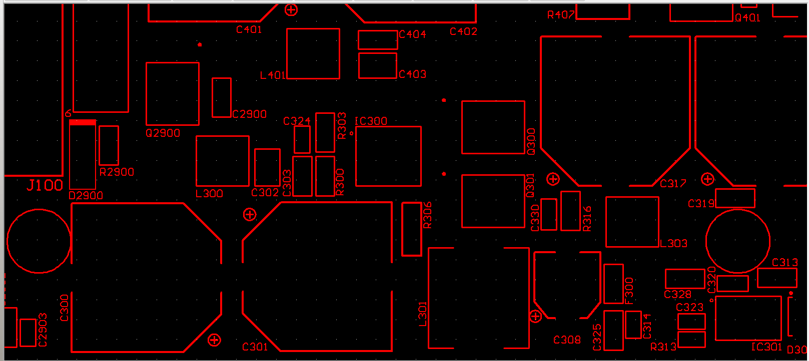

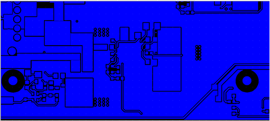

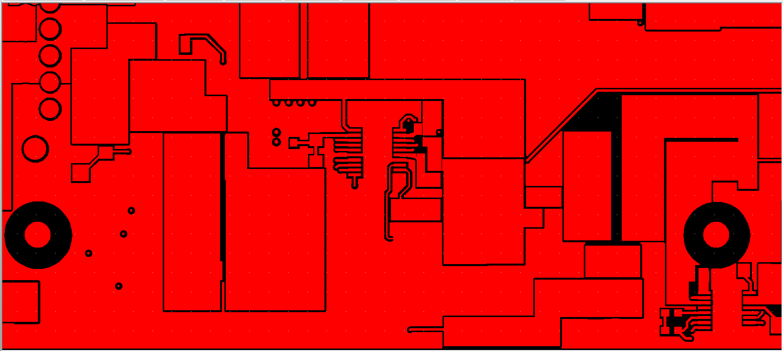

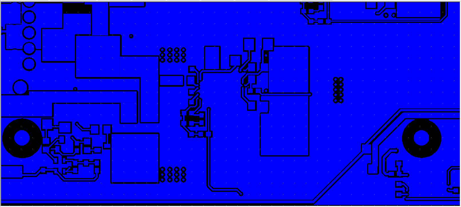

    Below I post the loyout of the section of the board where the Power supply is located. I couldn't get to show the viasholes but they are present where required.
    In this design we have used LM5575 where the voltage is about 20 V and it worked fine. The power supply here referred will work with a nominal voltage of 72 V but it could have transients up to 100 V.That's why we can not use directly the alternative integrated circuits you suggest.
    I hope the next pcb figures can help.
    Fig. 1. Top components silk screen

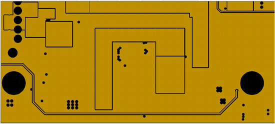

    Fig. 2. Top layer. Here can be seen that the DEMB pin is connected directly to GND plane with a vias. But the track was cut and a wire was connected directly to the negative teminal of Rs.
    Fig. 3. Firts internal layer.
    Fig. 4. Second internal layer.
    Fig. 5. Bottom layer
    Fig. 6. Botton component silk screen

  • I have soldered the the components with values that you suggested, and it didnot work.
    I have redesigned the PCB Layout and soldered again the values you suggested and it worked ok.
