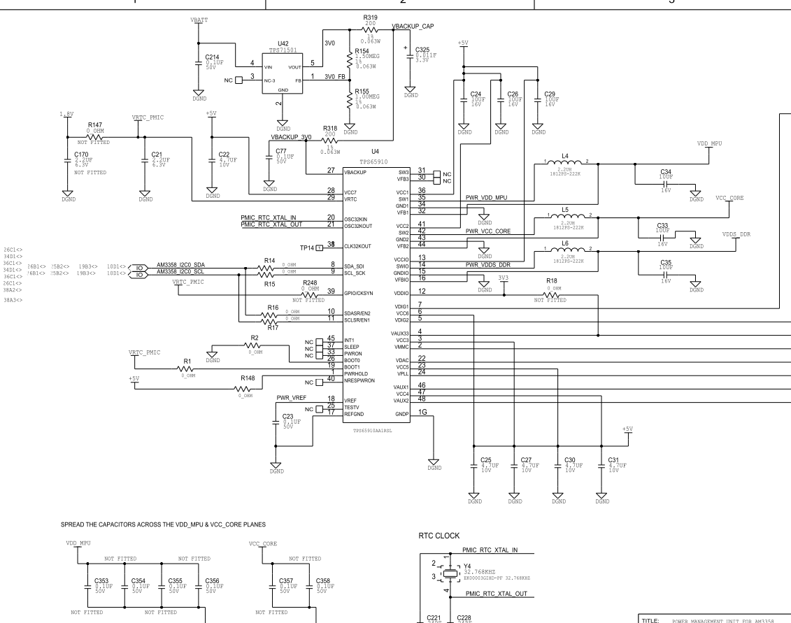

Currently we are experiencing the following issue with our system which has an AM3358 processor in conjunction with a TPS65910 (TPS65910AA1RSL) power management chip.
The system and processor powers up ok when we switch it on, but if we shutdown the system by setting bit 0 (DEV_OFF) of DEV_CTRL_REG (0x3F) to 1 using I2C communications, the system shuts down as expected, but we cannot then switch it back on again immediately.  We are also using the TPS65910 as our system RTC, which is backed up by a superCap to maintain the RTC for a period of time between system battery changes.
Investigations have led us to conclude that it is when this superCap has charge that we are unable to switch on the system.  Discharging the superCap manually allows us to recover and switch the system on.  Also leaving the system off for a long period of time (naturally discharging the superCap) works as well.

  • can you please let me know what is the voltage on backup pin , PWRON pin and PWRHOLD pins ?
    Is any of the other device off conditions are still existing when you try to boot up the device ?
    May be ot would be good if you can please share the schematic.
    Puneet

    I have attached the relative areas of the schematic.
    PMIC TPS65910A: 2845.PMICSchem.pdf
    Power Button: 1663.PWRButton.pdf  SW2 is the push button.
    PRE_AVCC and VBATT are 15V, our board can have its main 15V power supply as a either coming from mains/bench PSU or from a battery.
  • Hi John,
    I see on the schematic PWRHOLD is connected to 5v and when you write DEVoff =1 the 5v supply goes off. i am assuming after DEV_off you apply 5v on VCC& and PWRHOLD also , right ? This should wake up the device even without pressing poweron button as PWRHOLD is wake up event for device.
    Also, on the schematic i see PWRON pin is NC, where is the push button connected ?
  • PWRON is active low sinal but PWRHOLD is active high, PWRON just boots the device but PWRHOLD boots the device as well as keep s the device on. So to keep the device active PWRHOLD is required.
  • Hi Puneet,
    pushing the push button SW2 causes 5V line connected to PWRHOLD to go to 5V, I can see on a scope that PWRHOLD goes up to 5V for as long as I press the button, VCC7 also goes to 5V when I press the button, but when I release the button both these PWRHOLD and VCC7 go back to 0V when we cannot power up after applying DEV_OFF=1.  PWRON signal does exactly the same as PWRHOLD and VCC7, which surprises me as it is indeed listed as NC in the schematic.
    On a successful power up (when the superCap has been discharged), VDD_MPU comes up and holds PWRHOLD, VCC7, PWRON high at 5V.

  • John,
    OkI undestood what the circuit is doing now. Thanks. Did you try DEVOFF_RST bit, Is that bit doing the same ?
    when you monitor the VRTC voltage during the turin off seqnce does it ever go to zero and come back up again. or always stays on . This can tell if the device is in off state of backup state.
    Puneet
  • one more question , is this loop from PWRON on to MPU back to PWRHOLD how long is this duration.
    PWRHOLD has to be high within 1 sec of the PWRON press.
    After writting dev off bit , can you GND PWRON pins of pmic for short duration to check if the PMIC turns on. Need to maintin 5v on VCC7 during this.
  • Hi Puneet,
    Yes I have tried the DEV_OFF_RST as well, and the it behaves in the same way as the DEV_OFF bit.  Monitoring the VRTC, while I set DEV_OFF, I see that it stays at 1.8V.  Which state does this suggest the device is in?

  • Hi John,
    If VRTC stays aroung 1.8v the device is in backupmode.
    Puneet

  • Hi John,
    I dont expect PWRHOLD and VCC7 timing should be a major concern because PWWRHOLD is a wake up event it should boot up the device always as soon as it goes high. I suspect device is in backup domian here. Can you please try to remove the bakcup battery and check the device wake up every time , if so then we need to find a another way of to shut down the device and wake up on PWRHOLD event.
    Puneet
  • Hi Puneet,
    we have done this modification already by removing the voltage on the VBACKUP and yes it powers up every time; this has been a temporary fix for us when required.
    One thing I perhaps haven't mentioned before, is that sometimes it has powered up successfully with the VBACKUP in place after setting DEV_OFF.  So it is not a full 100% occurence of it not powering up, but it is very unusual for it to power up once we have done the DEV_OFF shutdown.

  • Hi John,
    There is a POR in the device with resets around 2v, if all the in votlages go beloew 2v including backupbattery everthing is reset inthe device . Same as no supply case.
    Puneet

    PoR is the internal signal , it cannot be accessed by software . When all the power levels goes belwo 2V ,POR is reset.From the information mentioned above if VRTC maints 1.8v always that menas device is tramsfering from on to backup state.Normally VDDIo is not required to be maintained in off or back up state. so this is fine .As there is no IO fucntion in back up and off state , it is just some internal triggers are maintain in backup or offstate to boot up.
    Puneet
