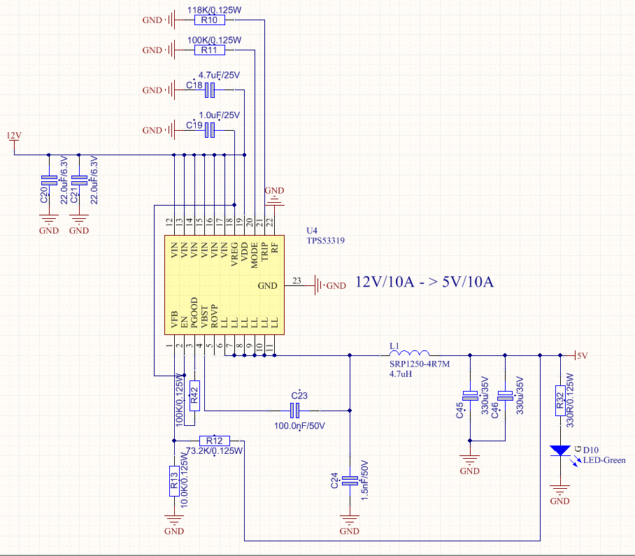

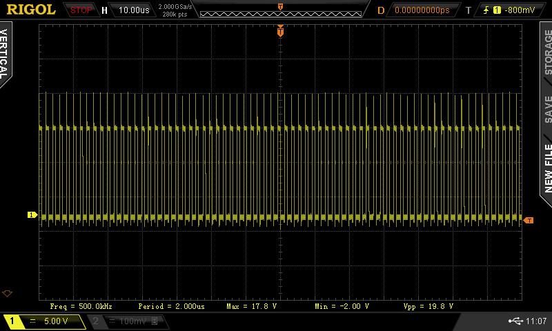

i am currently testing the TPS53319 with an input of 12V and an ouput of 5V at 500kHz switching.
I am currently accessing ~1A. Now the inductance (Bourns SRP1250-4R7M) gets hot (~40 degree).
That seems a lil bit for 15mOhm DCR. What is wrong?
