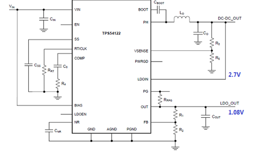

  • Hi Rodney,
    In the case of the TPS54122, you have an LDO with 200mV max of Dropout voltage for any current below 3A.
    I have reproduced below the spec of interest from the spec table.
    PARAMETER  TEST CONDITIONS MIN TYP MAX UNIT
    VDO(LDOIN)  V(LDOIN) dropout voltage I(OUT) ≤ 3.0 A, V(BIAS) – V(OUT_nom) ≥ 1.62 V 100 200 mV
    Setting the output of the DC-DC converter to a voltage at any voltage greater than 200mV, but less than 1.5V will ensure that you can achieve achieve 2.5A with the device without having any thermal issues.
    For lowest power consumption and good performance (PSRR), I would recommend 400mV to 500mV).  If power dissipation is an issue, but not PSRR then 250mV to 300mV would be sufficient.
    The internal DC-DC converter will convert the 5.5V to 1.3V with high efficiency (say 80%), while the LDO will convert from 1.3V to 1.08V (again at high efficiency since Vin and Vout are close).  Note that the LDO will need a BIAS voltage >= 2.7V (1.08V + 1.62V) to ensure that the dropout stays at less than 200mV.
    Figure 24 in the datasheet shows ~82.5% at 2.5A from 5V to 1.05V.
    So at 80% efficiency and 2.5A, the power dissipation would be 3.37W
    For 2A and 80% efficiency, the power dissipation would be 2.7W.
    With Theta_JA at 34.9C/W, the temperature rise will be ~94.3C for 2A and ~118C for 2.5A.
    You might still need some airflow for cooling the component if the ambient is above 25C.

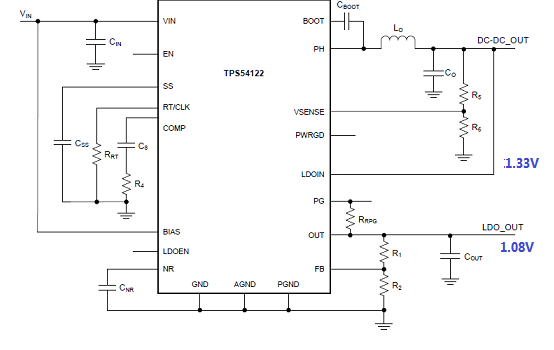

  • Hi Rodney,
    Here is the schematic with approximate voltage you will need to be at.  Note that the BIAS pin is now disconnected from the Vin as your nominal voltage is 5.5V and the Max acceptable voltage at BIAS is 5.5V.
    For the calculation, The output voltage is 1.08V and the current is 2.5A, giving:
    Pload = 1.08V x 2.5A = 2.7W
    Considering the 80% efficiency, this gives a power consumption at the input of:
    2.7W / 0.8 = 3.375W.
    I made a mistake there as the power dissipated in the TPS54122 is:
    3.375W - 2.7W = 0.675W.
    This will give a 34.9C/W x 0.675W = ~24C junction temperature rise over the ambient temperature.
    With+70C ambient, the junction temperature will then be 94C, which is safe under any circumstances for the device.
