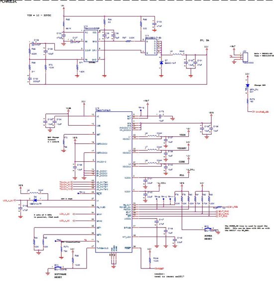

    Please post the schemtaic as an attachment.
  • 3426.bat charger.pdf
    Before I connect AC the battery is supplying 1.3A.  After I connect AC it drops to 0.  My 12V AC supply is sourcing .31A.  I do not have the register settings handy, unfortunately.  Our software engineer claims the battery charging register is set to the default values, which I believe enables the battery charger.

    Have you verified that your TPS40200 is regulating and capable of supplying the 1.7 A (1.3A (Ichg) + 400mA (load))?
    Also, you coud try clearing WLED_CTRL1[7] to see if removing the LCD load will allow you to reach the fast charge current limit.
  • Some notes on your recent comments:
    VSYS is at ~4.9V.
    The TPS40200 is regulated nicely and it is designed to provide up to 3A.
    As far as WLED_CTRL is concerned, bit 7 is already a zero.  We do not use the PMIC to power this particular display.  We use an on board boost regulator to provide 5V (from 3.3).

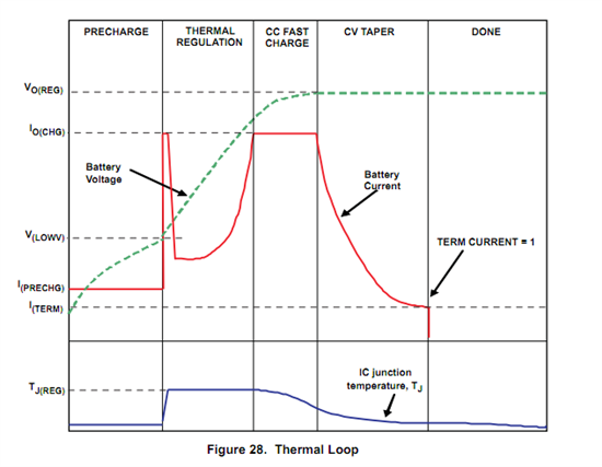

    One thing that would alter this is POWER PATH management.
    I suggest you measure the input current from the AC source into the TPS65xxxx while monitoring charge current.
    Monitoring input current and charge current would tell us if current is going out to the DCDC loads.
    The other thing that would affect charge current is THERMAL REGULATION. (previous post shows this graphically)
    This is a linear charger, so it will develop heat.
    Heat power dissipated = [Vin (VAC) - Vbat ] x Icharge.
    5V at VAC - 3.3Vbat = 1.7V,  at 1.2Amps the power dissipated is 2Watts.
    2Watts is a lot of heat in that package.
    Since the charge current slowly drops it leads me to believe the IC is heating up and going into thermal regulation.
    NOTE: the power pad must be soldered to a good copper plane for thermal relief as the data sheet shows.
