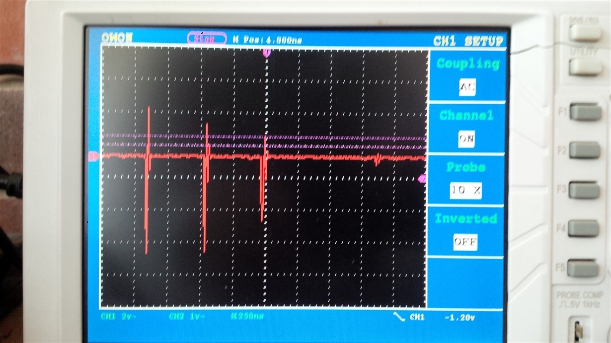

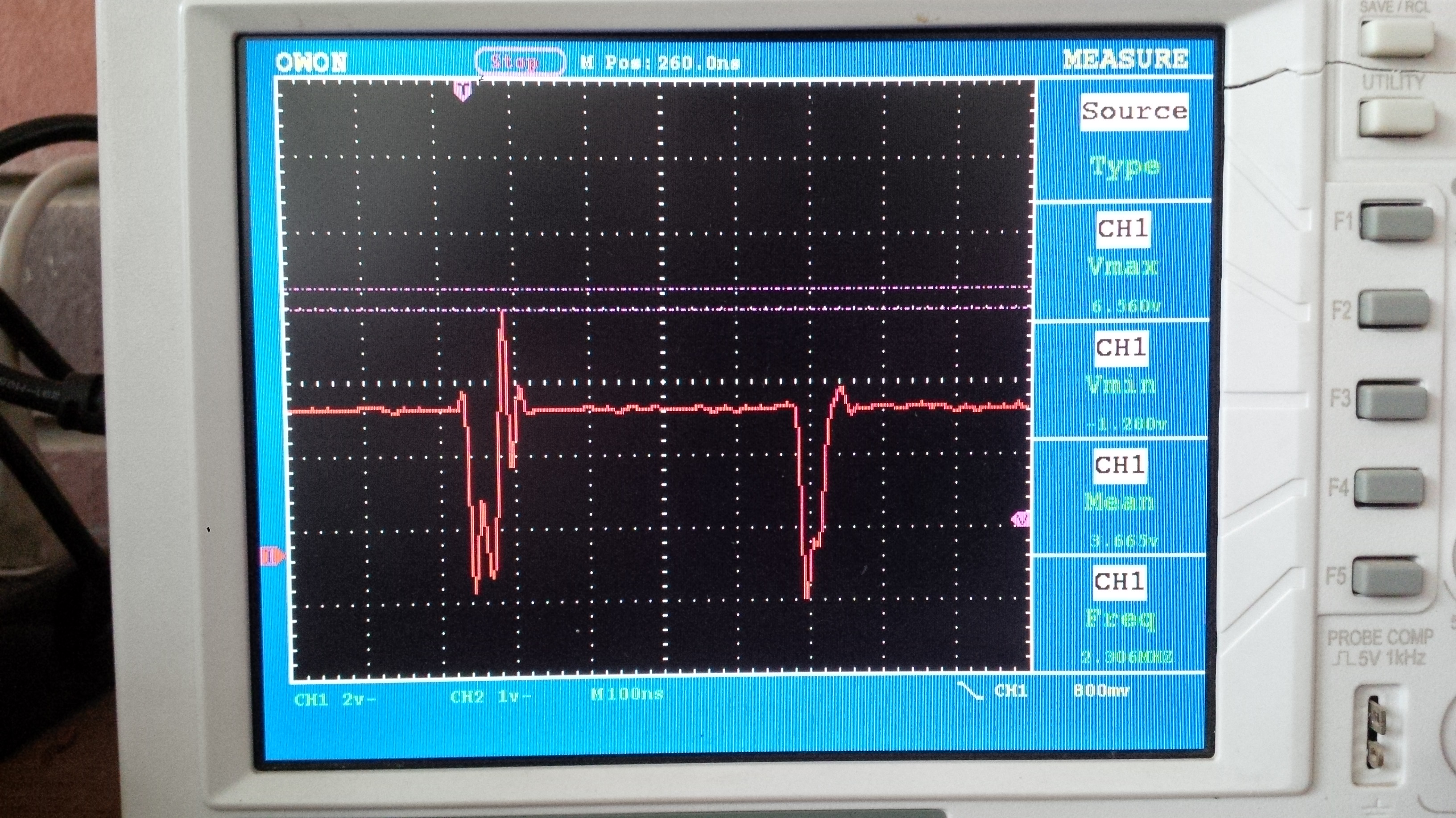

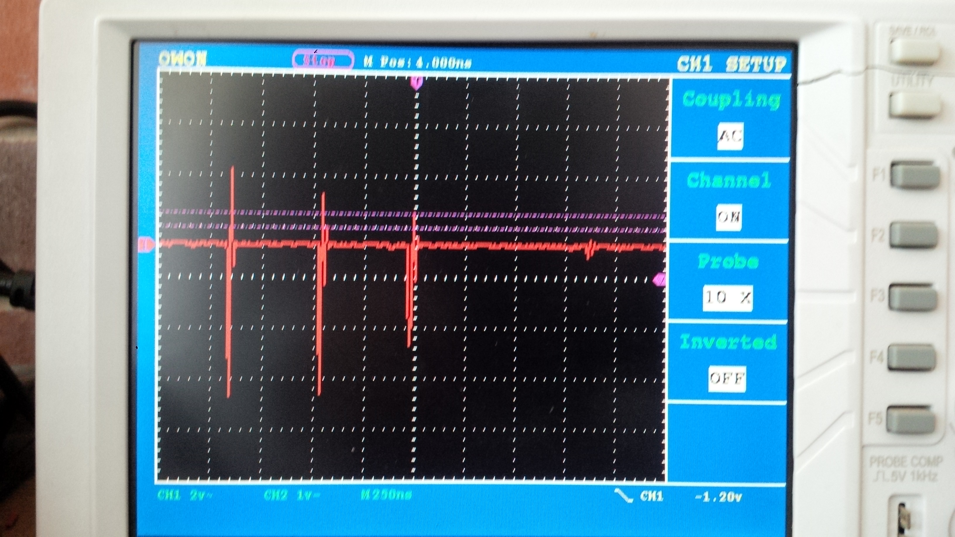

Hi Chris,
So the end user was able to confirm that the TPS62561 draws about 2mA with no load. I have a couple of boards in as well and have confirmed this.
Even though my layout is pretty bad (in looking into this I've found a number of things I could have done much better!) I don't see how it could be drawing that much current. The output is fine, with very little ripple, even on light load. (Though I will be doing some more evaluation.)
I've attached a scope capture pic of the switch pin (5) on the switcher (recall I'm using the TSOT23 package) with no load and with a 360mA load. (See below) They are not what I would expect from the various figures in the datasheet.
Some things to note
- the output is set to about 3.6V - I think this is a little on the high side for this part - any comments? (The resistor pair is 915K and 180K which has a sum greater than 1M which I realize is not ideal.)
- the layout has a small connection (12mil trace) to for the connection to Vin as well as from the base of R1 (180K) to the ground of the chip due to bad layout. I've fixed these up manually but it doesn't seem to change the behavior of the board. (Again I will evaluate more.)
Any ideas at all as to what might be creating this current draw? (I've ohmed out the boards and there isn't any noteworthy continuity between the output and ground.)
I can provide my schematic and layout if that would help.
Thanks so much,
Kurtis Unger
No Load
360mA load
