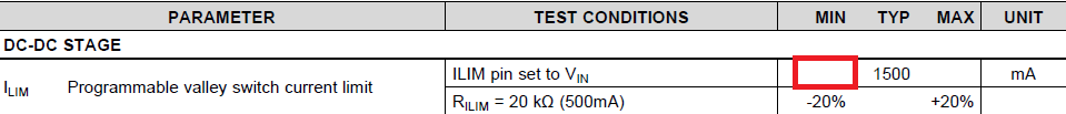

Hi Team,
Our customer would like to know the current limit minimum value at ILIM pin set to VIN.
We are conjecturing that this value is “1500mA * 0.8 = 1200mA ”.
Is my understanding correct?
If no, could you please let us know this value if you have this information?
Kanemaru
  • Hi Kanemaru,
    I checked with our test engineer and designer, only the 500mA current limit item is guaranteed, the minimun current limit is -20%. In case of ILIM pin tied to Vin, it's not guaranteed that the minimum current limit is 1200mA, but the minimum value should not shift too much.
    Is the customer's applicaiton just around 1200mA boundary?
    BR
    Gene

  • Hi Kanemaru,
    I'm a little confused. It seems that your customer decide to choose the IC in the first place and then decide their application of Iout. In my opinion, it should determine the application of Iout first and then choose a appropiate IC.
    Anyway, in terms of TPS61252, there's no data to guarantee the minimum current. But I think current limit should not be lower than 1A. In our bench result, with Vout=4.5V, when Vin=2.3V, the max Iout is nearly 500mA, when Vin=4V, it's larger than 1A, just for your reference.
    BR
    Gene

  • Hi Kanemaru,
    I think TPS61252 can handle your customer's application. TPS61252 is a valley current control device, not peak current control. So 570mA will not trigger current limit.
    BR
    Gene
