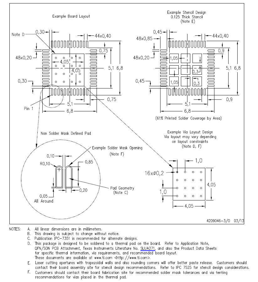

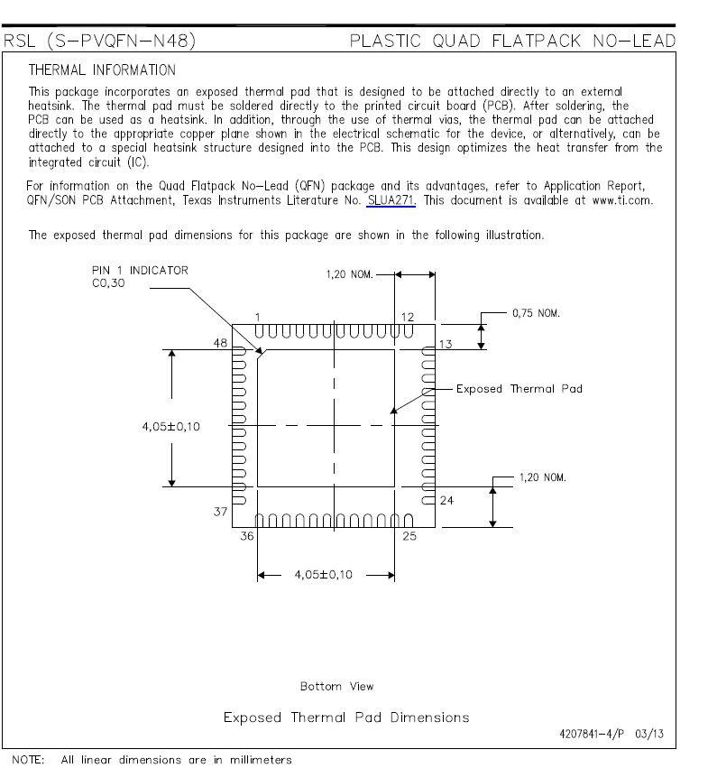

I'm making a Am335x design with the TPS65217C. In the datasheet there is no drawing of the thermal pad. It says "Size and shape shown on separate sheet", but there is no separate drawing of it in the datasheet. SLVSB64G.
-Michael Hallin
-Michael Hallin
The information can be found on the following two pages of the data sheet, as well as here: http://www.ti.com/sc/docs/psheets/type/type.html
There are no following pages in the datasheet. You are right this information usually is on the next page in the datasheet, but this is missing from this datasheet. I have found several products that uses this "RSL" package, but the thermal pad layout is different. Some of the products have an offset thermal pad.
The information You point to is the general package drawings, and this also points to the specific datasheet to see a drawing of the thermal pad layout.
-Michael Hallin
slua271a[1].pdfAre you missing the pages i have attached? or this still isn't what you are looking for? I've also attached an app note with this infomation. Let me know if this helps
