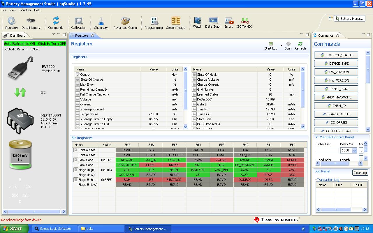

    I have made that update procedure and there is a result but I am not sure if it is ok. Graphics on the left side of bqStudio are active (icons are in color - not grey), but not always. They are changing from time to time and when I try do execute the update again I am getting communications in bottom part of bqStudio window: "No acknowledge from device." or "Lost communications with adapter." What could be the reason?
    When I tried just to read data from device via "bq Evaluation Software" version 0.9.90 I get communication error: "Error reading Data Flash Subclass Lifetime Data, Code=772"
    Maybe the problem is that I am using this bq34z110 in my own board (I bought the IC, designed PCB and mounted it) and now I have unseal it or something?
  • You upgrade the bq34z110 device to bq34z100-G1. Could you send a screenshot of the bqStudio screen? I may see something that will help. Just to confirm, that you press the Execute FW button after loading the srec file? Did you try closing and reopening bqStudio?
  • I am not sure if it is upgraded or not. I am using DC power supply instead of battery, maybe that is the problem? I will try to check if my soldering job was done in proper way. I have state logic analyzer also so If You have other idea how to check it using this device... Any way thanks for supporting me.
  • The screenshot shows that the gauge has not been upgraded to bq34z100-G1. You need to go to the Programming screen and upgrade the firmware and then it should work better.
  • I am still getting message "No acknowledge from device" during upgrade try... I read all advices from e2e forum and I do not know what it could be. Is it possible to do it without upgrading with bq Evaluation Software? When I try to open it with bqEVSW I am also getting a message about acknowledge error: No Acknowledge: VB_T2H_NACK
  • Does it work properly if you use the bqEVSW and program the bq34z110 firmware into the pack? The bqStudio program is not compatible with the bq34z110 and you could have communications issues. I am not sure why you have issues are upgrading the firmware. We have had users report issue with various computers. Do you have another computer that you could try?
  • I tried on Windows XP and Windows 7 with bqStudio. With bqEVSW on XP only (it does not work on 7) and there is the same problem with communication. There have to be something wrong with my PCB. I doubt that gauge is broken (voltage on REG25 is 2.5V). I have try to check PCB again or use another computer.
