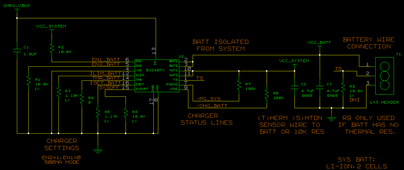

       In our design we are using BQ24079 battery charger IC for charging 3.7V Li-Ion battery using USB.  The battery is not charging.  I have used the same schematic as that is shown in page 1 of the datasheet of BQ24079. Even the resistor values on ILIM and ISET are the same as per this schematic.
As per the table shown on page 6 - EN1 is high and EN2 is low, so i should get 500mA charging current. But I am not getting more than 10mA !!
Kindly advise what are the critical parameters that could lead to this problem

  • What is the TS pin connected to? It should be connected to either a 10K NTC in the battery pack or a 10k ohm resistor to ground. Can you send me your schematic just to double check?

    We are experiencing the same issue (with the BQ24075). I don't want to hijack your post, but we may be experiencing the same cause/effect.
    Our charge current for a 4.2V Li-ion is 1mA, and the TS pin's voltage is below (at 1mV) the thermal cutoff point defined in the datasheet. We have tried both a 10k NTC and a 10k resistor to ground on this pin with the same result (on two different PCBs).
    We also have the reference board HPA282 with the BQ24075 on it, and have configured it to match our schematic as much as possible. This circuit works fine.
    Schematic:
    Matt Dailey
  • Okay, I think I resolved our issue. We designed for the BQ24075, but purchased the BQ24075T. The part we're using requires external sourcing of the TS current, so not doing so will leave the voltage at 0. You may be experiencing the same issue, Atul. See the forum post below:
