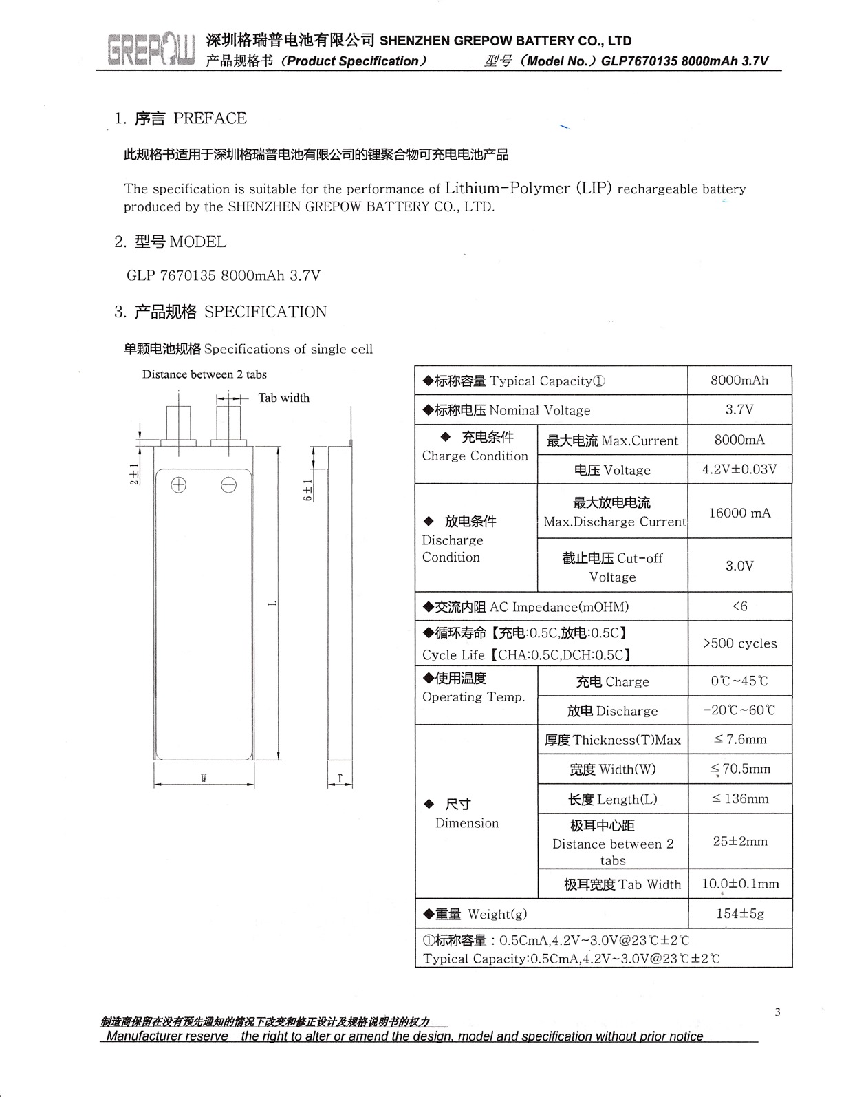

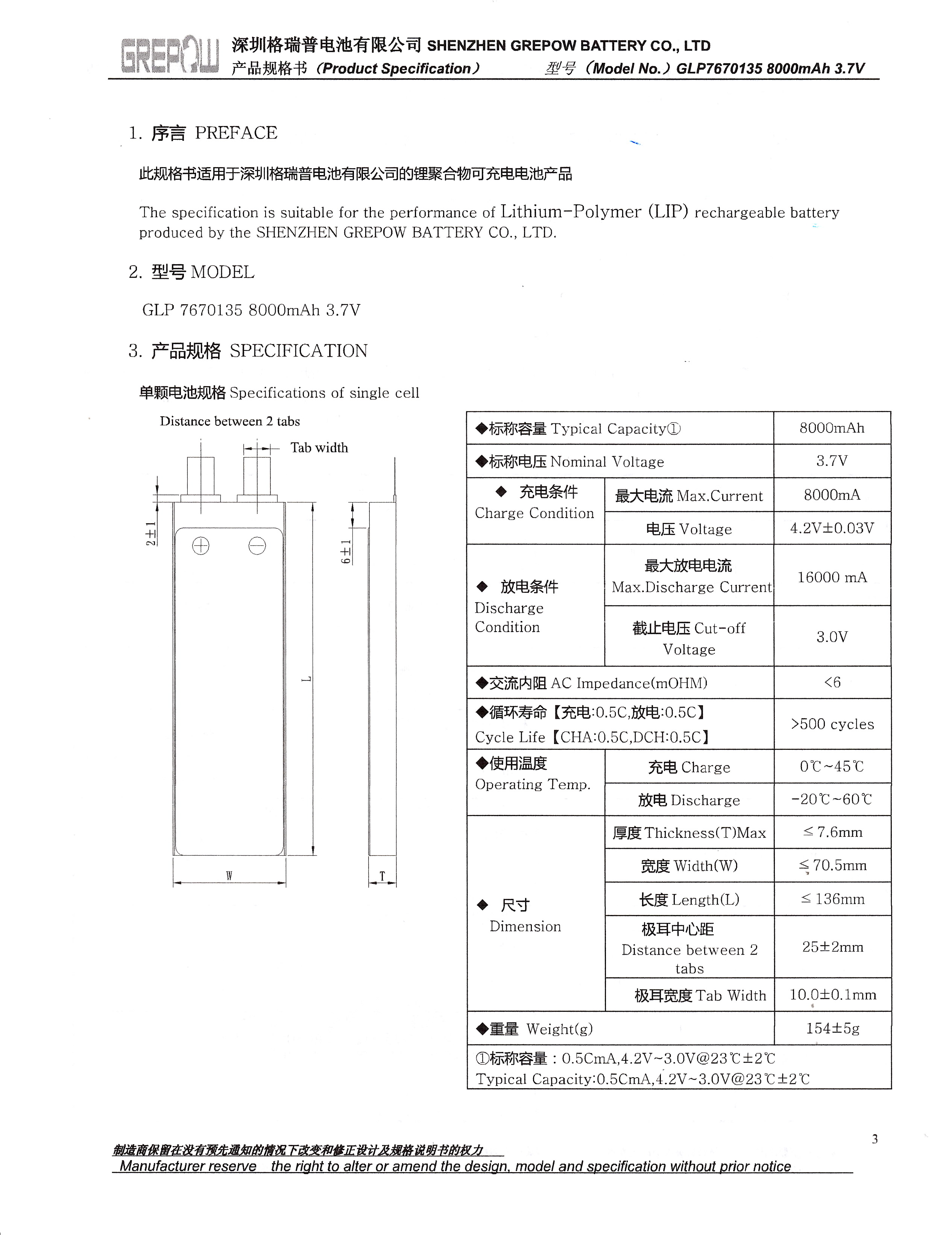

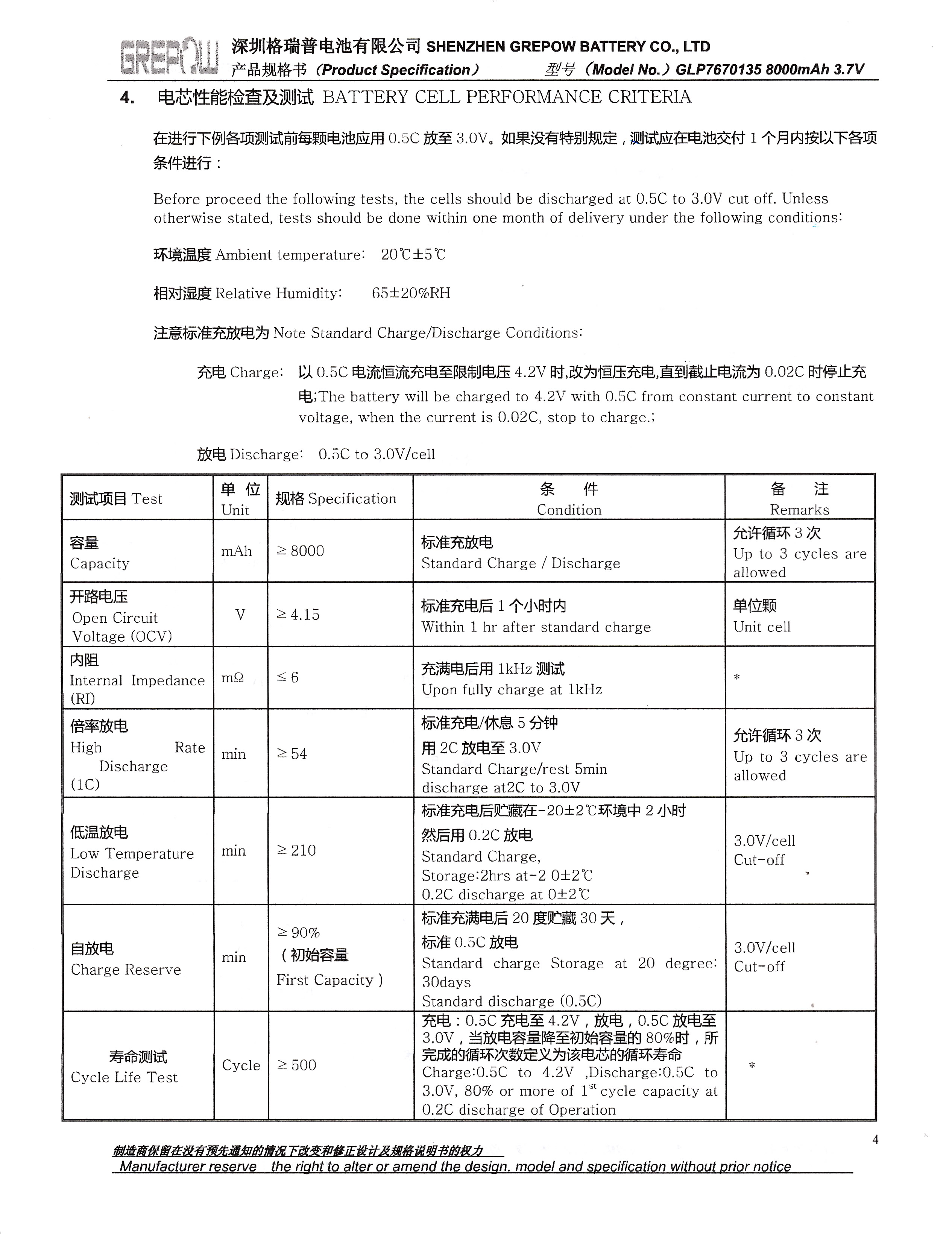

I am currently using the BQ78PL1116 and I can not find a Lithium Polymer 8000 mAh cell file for that chemistry type. The Cell chemistry is a LiCoO2 which is very common but most of what I have seen on the site is all 18650 cell types. Is there anyway you can help me find the chemistry ID for the BQ wizard program?
I have the Cell Spec sheet for this cell please contact me if you need me to email you that sheet.
