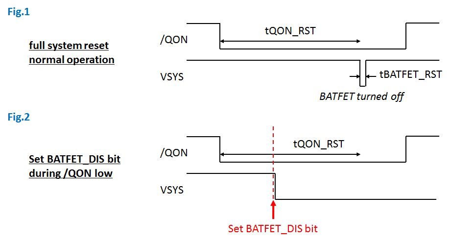

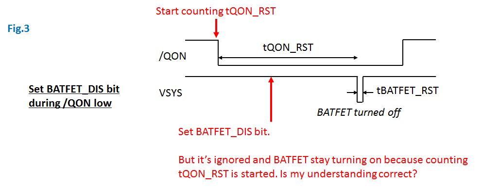

Please let me ask about full system reset and BATFET_DIS bit.
Is BATFET turned off by set BATFET_DIS bit during /QON low to enable full system reset like Fig.2 in attached? Or is BATFET_DIS bit ignored and enabled full system reset after tQON_RST? This can be confirmed by using EVM easily but I'm sorry but I have not gotten EVM yet...
