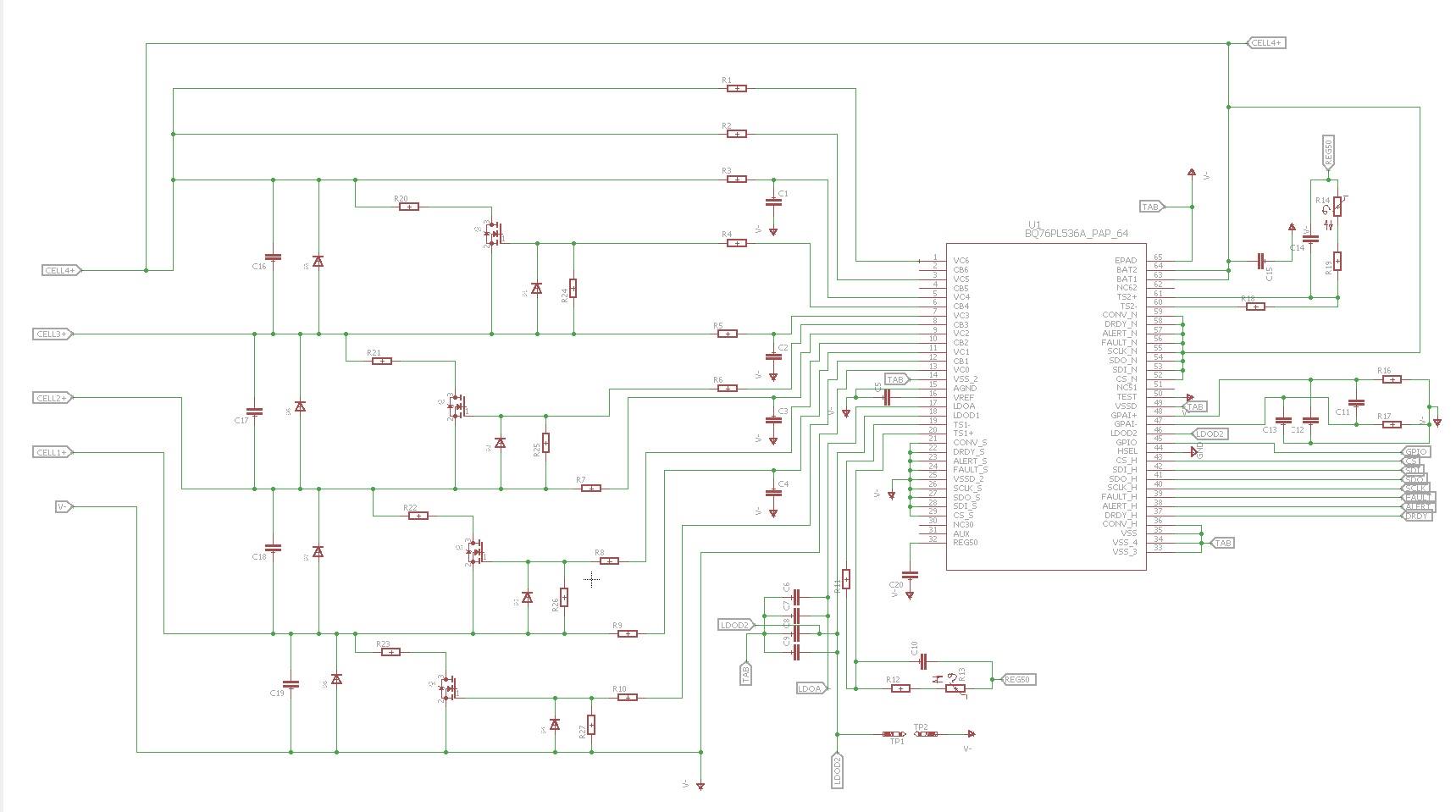

I am designing the circuit in Eagle Software and i am facing small issue regarding the design of the schematic.
In the data sheet, circuit diagram is given for connection of 3 IC's ,since we are designing for 4 series cell,I am using one IC. So as of given in the data sheet www.ti.com/.../slua562.pdf ,we gave connections as mentioned in the pdf i.e. we shorted the top interface pins to Vbat and bottom interface pin to -Vss.But we are getting lot of errors.
Please suggest the right way of connecting these interface pins and let me know whether the Vss is a negative supply of the cell or the ground connection.
Thank you. Here below I have attached my eagle schematic file .Can you please tell me where the mistake is and a solution for it.
Here below I have attached the eagle schematic pdf and the erc errors pdf which i got as errors. please suggest me some solution for this.
Christopher,
I found few issues.
1. Connect HSEL to GND NOT LDOD. This is probably THE biggest problem.
2. Missing a CAP on REG50.
3. I didn't see VSS (all ground pins) connect to V-.. DId I miss this?
Make these changes and try. You should see better results.
Check the Cap and resistor values and compare with reference schematic.
Thank you . We have resolved the first two problems and the third one we are not clear with your answer , we already given all the pins to v- only . do we need to give those connections to ground or v- . and still we are getting the same errors. Here i have attached the corrected circuit. and tell errors i sent you in the previous message. Could you please suggest some solution to solve those problems.
You connected all GNDs to TAP(net),
I want you to connect all GND pins such as VSS1, VSS2, AGND and etc.... to V-.
Try this
I have connected the pins as suggested by you,still i am facing with the same old errors.
The errors are mentioned below:
1.More than one output pin on net CELL4+
2.OUTPUT and SUPPLY pins are mixed on net V-
3.SUPPLY pin V- overwritten with more than one signal(V-,TAB)
All the above errors are related to the V- signal only,so please suggest me some solution to resolve these errors.
I thought you had issues with board but I guess you are in design stage.
I made some comments and try that.
Do you have our evm schematic?
If yes then use it as reference.
I suggest you to follow it exactly for now. Eagle_Schematic (2).pdf
Autorouter can't finish the schematic due to the tight layout and you need to route it by hand.
This is why we spend hrs routing by hands.

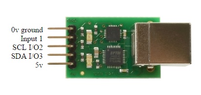

Hello
I have designed the board for my test bench using bq76pl536a for 4s3p li ion battery. since I am not using microcontroller , I am trying to connect my board to computer using USB to i2c communication module , but these pins and the pins which were given in the ic are not matching. so can you please suggest me how to interface the communication module to the ic board.Below i have kept the image of the communication module.
If you are using TI GUI then you need to use the Aardvark. you need a SPI communicator. Check out TP240141. You need a USB to SPI.
thank you, is that IC preprogrammed with any threshold voltage values to balance or do we need to program it on our own by interfacing with MSP430 or with aardvark.
Yes, you have to program them. Default register values are all 0s.
you can program OTP once then you are done or you can write to the registers. If there is a POR then you have to write to registers again.
Check out the datasheet. They are all in there.
