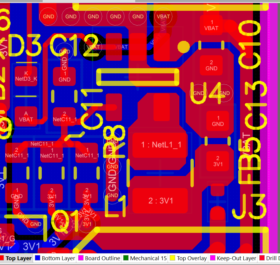

I am using an LM3671 in a design and have had a few failures where the switch pin seems to be short circuit internally. I am just starting the investigation into why this may be occurring but I noticed something that was missed when first laying out the board.
The datasheet 'recommends' that enable is only pulled high once the supply reaches 2.7V. In our design the enable is tied to Vin.
Interestingly reading the reference board manual it says that "the enable pin should never be taken high until minimum guaranteed operating voltage of 2.7V is reached".
When you look at the block diagram there is a UVLO block on the enable input - I guess that does not function to protect against the above statements?
While I continue to conduct my investigation into the failures I am interested to know if their are any known failures through tying enable to Vin and what the risks are to operation. Could this lead to an output short circuit?

  • I've searched the community and couldn't really find an answer to your original question. I too have designed a board with the enable pin directly shorted to Vin. The board I designed is on 1 square inch and there isn't any room to add an additional circuit. I've started some testing on the first prototypes and I believe I've run into some issues with the LM3671 (I'm using the LM3671MF-ADJ) where it seems that it is shorted. Unfortunately I am out of the office and only have some limited tools to test. The initial power up and check of signals looked good so I thought I was OK to just concentrate on firmware while I was gone.
    I'm guessing a short because if I try to bypass the LM3671 by inserting 3.3V on it's output rail the inductor gets hot quickly but the current draw of the board is only 250mA so it can't be a direct short.
  • Fortunately I had additional space to add a startup control circuit. However I also added a schottky diode between the switch node and ground. Although this is a synchronous converter the external schottky can help overshoot on the switch node that I thought may also be damaging the part. I added a PMEG3015EH which seemed to reduce the overshoot.
    My startup used a Microchip MCP112T-300E/TT with 100k pull-down. These devices tend to have an unknown output up to 1V or so but that still keeps the EN pin within spec during startup.
    My layout followed the design guidelines and the components tightly placed with wide traces so little I could do to reduce the ringing without the additional diode externally.
    I haven't seen any further failures of this since updating the board, but as I added the startup circuit and the diode at the same time it is difficult to say which could be improving things.

    I asked TI for advice on the allowable overshoot as I think the datasheet says the output cannot go above Vin plus a small voltage. Typically the switch node of SMPS has ringing even with a tight layout and mine was exceeding this. I read up on synchronous converters and how to reduce switch node ringing and several sources suggested an external schottky.
    Regards, Mark
  • I saw that, thanks. That schematic doesn't show the schottky, just the delay circuit on the enable pin. I've only got a volt meter with me but I measure ~9 ohms from Vin to GND on 1 board and ~40 ohms on the other board. Seems like mine are damaged but not all the way. I'll see if I can find those notes you were reading about adding the schottky to reduce ringing. I'm using the adjustable version which has caps in the feedback network which might change the behavior, improving or making worse I'm not sure.
  • The schottky was added between pin 5 and 0V (where a schottky would be in a non-synchronous buck converter), with cathode towards pin 5, anode to 0V.
    Take care in schottky selection. I tried a few types with varying success. The ringing is caused generally by parasitics to difficult to predict and measure.
