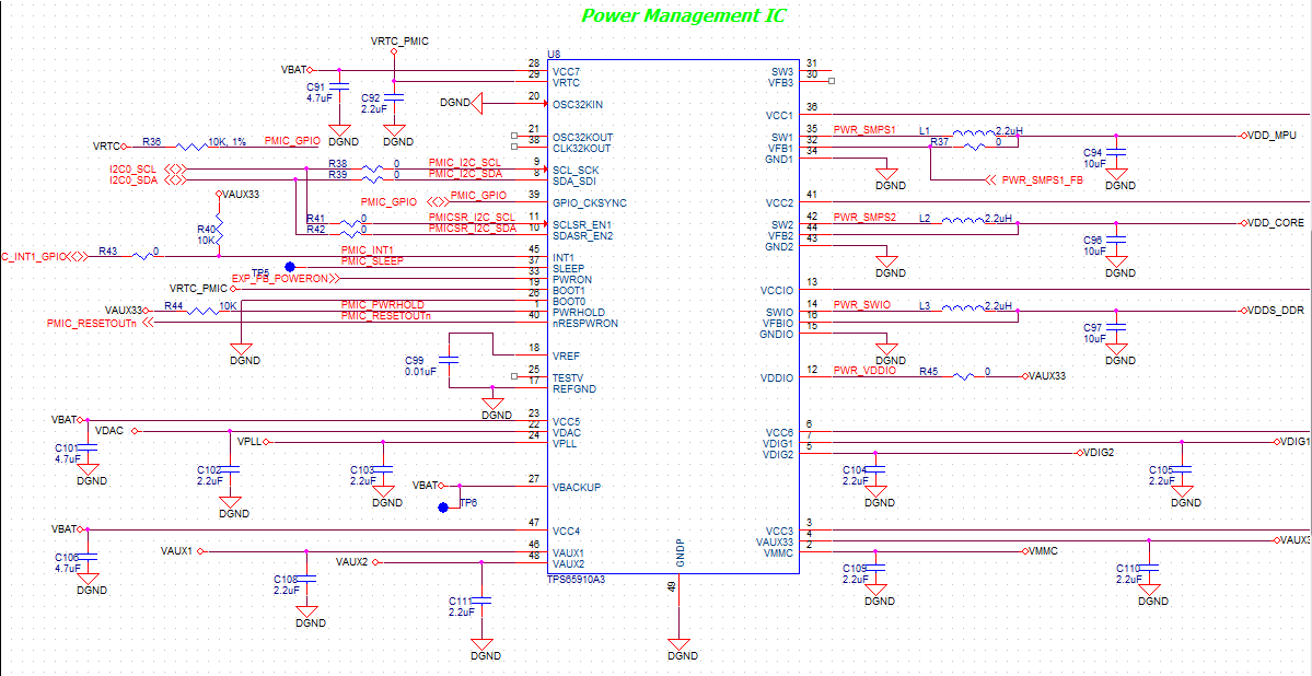

   My customer has an issue as below link:
https://e2e.ti.com/support/power_management/pmu/f/43/t/246411
And they are using button for TPS65910 start up. Before pushing button, the VRTC of PMIC is 1.8v.
But it will be 2.5v after PMIC start up.
The schematics design is the same as AM335x starterkit's
