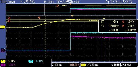

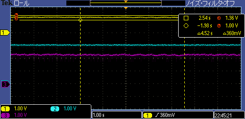

  • Hello Chris-san,
    I have got  two waveform, but that are with changed capacitors values and seems work good.
    (due to changing parts and  preparing test equipment, the waveform with inrush current will be available next week)
    So, today' questions from the customer are as below,
    - Are these values reasonable  for their application ?
    - Is there any calculation formula for Cin, C1F,C2F values ?
    the changed values:
    Cin=470uF, C1F=C2F=0.47uF
    the colors of the waveform:
    Vin=yellow, Vout1=purple, Vout2=light blue

  • Yes, providing energy from a current limited source usually requires a larger capacitor as you have on the front end. I would recommend making the other 5 capacitors around the TPS60311 be the D/S recommended 1 uF value. For sure, the IC requires a 1uF right next to its pins after the switch shown in your drawing.

  • We don't have a model for this very old device.
    There is no precise formula. They will need to test it empirically in their system. As well, I assume the output characteristics of their source have no formula.
    Basically, you need to store enough energy in the input cap to power the load and charge up the output caps.
