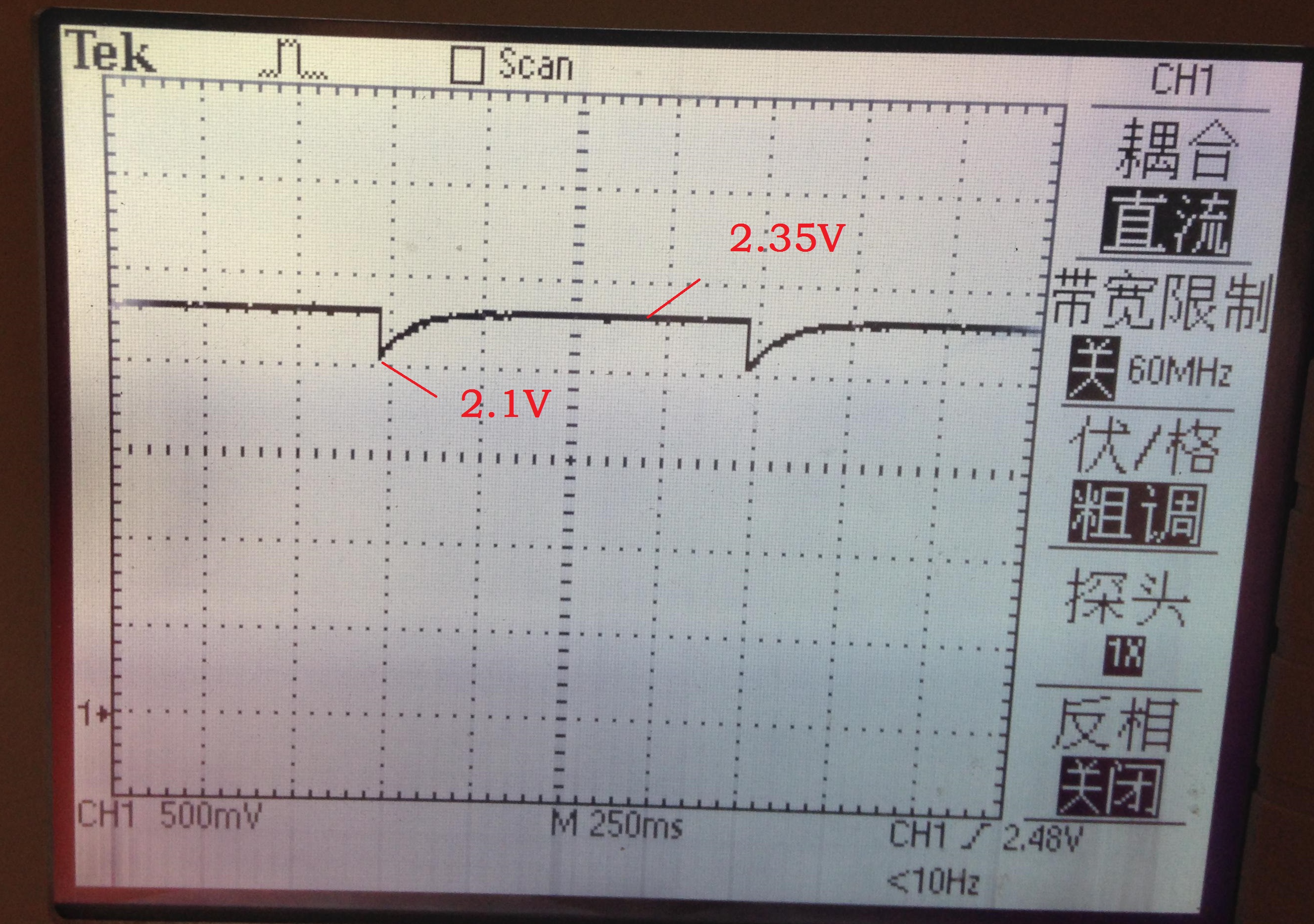

1. With POWER_SAVING enable.
    The Vout of TPS62730 should be stable 2.1V. But I get the following waveform.
      The Vin of TPS62730 is 3V, which is connect to a TEK power supply.
      The time interval is 1s, which is the ADVERTISING_INTERVAL.
      As can be seen in the figure, the Vout of TPS62730 rise to 2.35V when CC2541 goes to PM2 mode. That is quite strange.

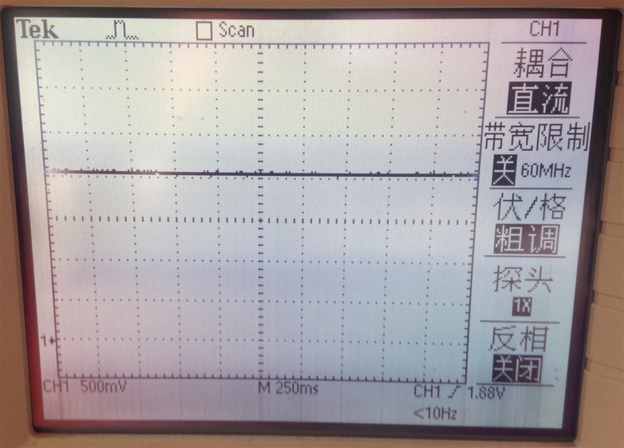

2. With POWER_SAVING disable.
    The Vout of TPS62730 is stable 2.1V.

      I think in 2,3,4 shows that, the problem may have some relationship with Iout of TPS62730 on my board. It seems when the Iout is too small, the Vout rises to 2.35V. So I tried the 8 experiment.
5. I disconnect the Vout of TPS62730 to the power net on my board, so that Iout is nearly 0. (P1_5 is still forced to 1) I suppose to see the Vout be unstable. But the result is: 2.1V Vout is stable.

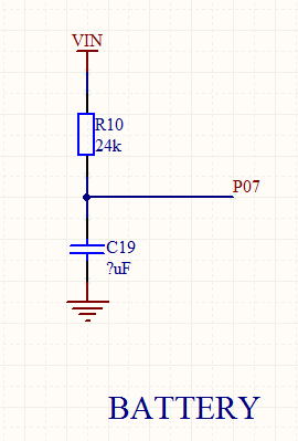

            Finally, I found that when the R10 is removed, the 2.35V problem is solved. I made a mistake. I used to want to monitor the battery voltage(VIN) through P07, so I connect VIN with R10 to P07. But TPS62730 output 2.1V, so VIN is higher than VCC, which cause the problem.

    Good to hear that you resolved the 2.35 V issue. For battery monitoring you can put the regulator in bypass and then measure the supply voltage directly with the ADC.

    I made a mistake in the schematic, I connect VIN which is 3V to R10. That makes P07 has a higer voltage than Vout of TPS62730, and that cause the 2.35V problem.
    I connect Vout of TPS62730 to R10, and then the problem is solved.
